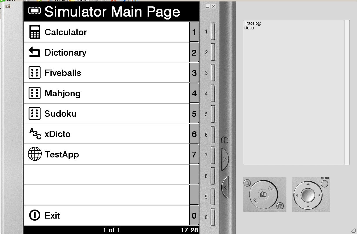

Modified eBookSim.xml for a screen-resolution of 800 lines
There are two ways of using it:
  1. replace the current eBookSimMain.xml with the attached one while renaming it from eBookSimMain800.xml to eBookSimMain.xml
  2. Change this line in eBookSim.xml
    <document href="[applicationPath]eBookSim/scripts/eBookSimMain.xml"/>
    to
    <document href="[applicationPath]eBookSim/scripts/eBookSimMain800.xml"/>
If you are using a lower resoltion you can shift the skin further up by changing this line in eBookSimMain800.xml
 <panel id="MAIN" skin="panel" visible="true" left="0" right="0" top="-37" bottom="0">
but you will cut of part of the top permanently. As the application window cant be "pulled" greater then the actual screen-res.
ID:	62477   Click image for larger version

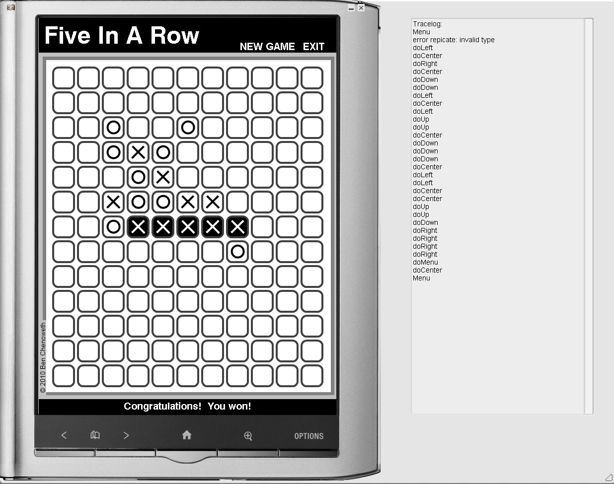

New game to try: Five In A Row
Hi Mark and others,
I've finished the first draft of my game for the PRS test environment. It works in both Touch and non-Touch (although it is far easier to use in Touch mode!) Hope people enjoy it!
If you discover any problems, please let me know.
Sincerely,
Ben.
P.S. Kartu, I would be very happy for you to include this in PRS+! I actually spent the last few days programming this game as a thank-you to you for all your work on PRS+. I am really enjoying it on my 600!
EDIT: Attachment removed. The updated version is available in post #77 of this thread (located on page 6).
UPDATE: Latest version now found in post #145.
Last edited by BenChen; 02-10-2011 at 09:04 AM. Reason: Zip file moved to post #145
BenChen is offline   Reply With Quote
Old 12-09-2010, 11:18 AM   #67
Mark Nord
2B || !2B
Mark Nord ought to be getting tired of karma fortunes by now.Mark Nord ought to be getting tired of karma fortunes by now.Mark Nord ought to be getting tired of karma fortunes by now.Mark Nord ought to be getting tired of karma fortunes by now.Mark Nord ought to be getting tired of karma fortunes by now.Mark Nord ought to be getting tired of karma fortunes by now.Mark Nord ought to be getting tired of karma fortunes by now.Mark Nord ought to be getting tired of karma fortunes by now.Mark Nord ought to be getting tired of karma fortunes by now.Mark Nord ought to be getting tired of karma fortunes by now.Mark Nord ought to be getting tired of karma fortunes by now.
Posts: 854
Karma: 327896
Location: Austria
Device: Sony PRS505/650/T1/tolino vision 5
Wow!
Works like a charm!
And it is not the first piece of JS-code you are doing, I assume.
Will try on the PRS-505 ASAP.
Startup-Code for PRS+ v2.0.x attached.
ID:	62544   Click image for larger version
File Type: zip FiveRow_StarterCode.zip (557 Bytes, 208 views)
Mark Nord is offline   Reply With Quote
