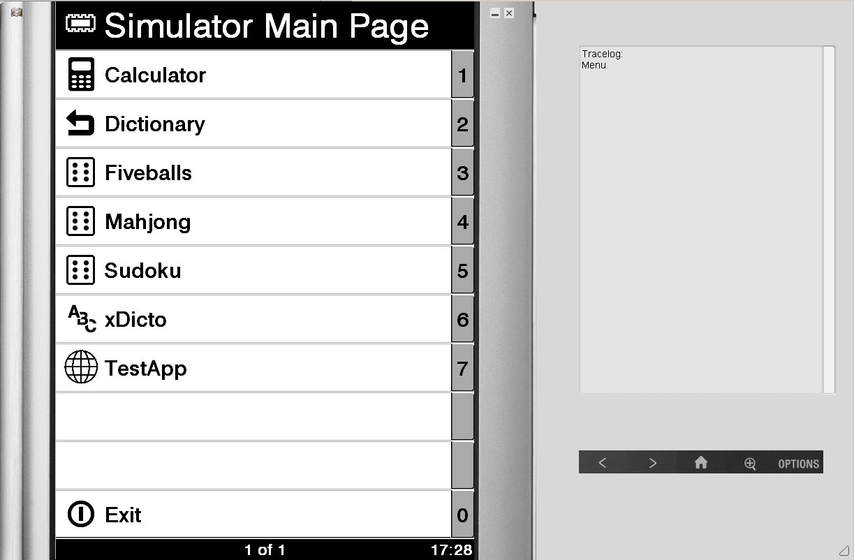

Modified eBookSim.xml for a screen-resolution of 800 lines
There are two ways of using it:
  1. replace the current eBookSimMain.xml with the attached one while renaming it from eBookSimMain800.xml to eBookSimMain.xml
  2. Change this line in eBookSim.xml
    <document href="[applicationPath]eBookSim/scripts/eBookSimMain.xml"/>
    to
    <document href="[applicationPath]eBookSim/scripts/eBookSimMain800.xml"/>
If you are using a lower resoltion you can shift the skin further up by changing this line in eBookSimMain800.xml
 <panel id="MAIN" skin="panel" visible="true" left="0" right="0" top="-37" bottom="0">
but you will cut of part of the top permanently. As the application window cant be "pulled" greater then the actual screen-res.
ID:	62477   Click image for larger version

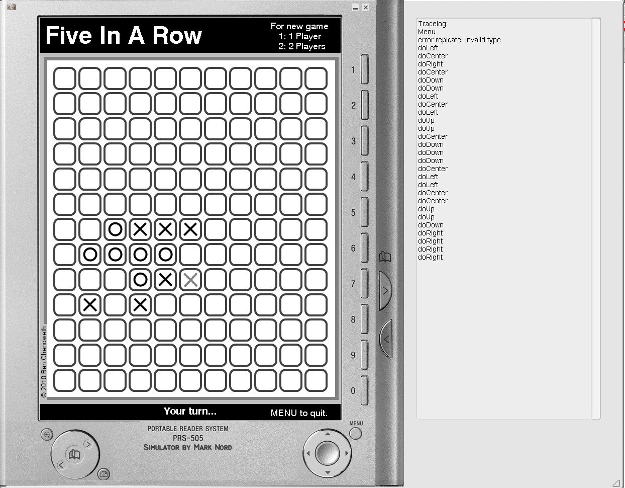

New game to try: Five In A Row
Hi Mark and others,
I've finished the first draft of my game for the PRS test environment. It works in both Touch and non-Touch (although it is far easier to use in Touch mode!) Hope people enjoy it!
If you discover any problems, please let me know.
Sincerely,
Ben.
P.S. Kartu, I would be very happy for you to include this in PRS+! I actually spent the last few days programming this game as a thank-you to you for all your work on PRS+. I am really enjoying it on my 600!
EDIT: Attachment removed. The updated version is available in post #77 of this thread (located on page 6).
UPDATE: Latest version now found in post #145.
Last edited by BenChen; 02-10-2011 at 08:04 AM. Reason: Zip file moved to post #145
Wow!
Works like a charm!
And it is not the first piece of JS-code you are doing, I assume.
Will try on the PRS-505 ASAP.
Startup-Code for PRS+ v2.0.x attached.
ID:	62544   Click image for larger version
File Type: zip FiveRow_StarterCode.zip (557 Bytes, 214 views)

BenChen, i've tested the game, but when i'm playing i don't see a mark to know where the cursor is. is it posible to implement in the code this?
In mode touchscreen, when i click on the screen, nothing happens.
thanks

Are you using the latest version of the Test Environment? I don't know if that would make a difference. On my computer, when you click a square with the mouse, your X just appears.
There is a cursor in non-Touch mode, however.

@ VICTORSJG
startcode in "eBookSimMain800.xml" <function id="setView" params="app"> should look like this:
	 case "Fiverow" : {
			kbook.autoRunRoot.getSoValue = _Core.system.getSoValue;
			kbook.autoRunRoot.hasNumericButtons = _Core.config.compat.hasNumericButtons;
			this.MAIN.EINK.VIEW.setURI("../addons/Fiverow/fiverow.xml");
			break;
Mark Nord is offline   Reply With Quote

Mark now it's ok, the mark appears when i move the cursor, i had forgotten incluide in the scripts the numerics buttons.
Thanks
