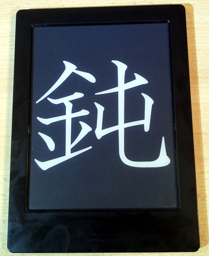

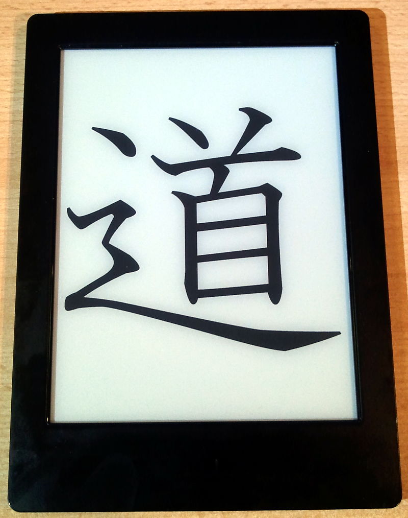

This mod displays a random "screensaver" PNG image on sleep/poweroff.
Please note this is a built-in feature since Firmware 4.13 according to @davidfor
---> https://www.mobileread.com/forums/sh....php?p=3868795 <---
=== Installation steps: ===
  1. Disable "Show current read" in Kobo's privacy/power settings.
    (mod requires blank Sleeping / Poweroff screens)
  2. copy KoboRoot-ScreenSaver*.tgz » .kobo/KoboRoot.tgz
  3. eject/umount device, disconnect the USB cable
    (mod does not work while charging)
    --- KoboRoot.tgz will automatically install & reboot ---

  5. let the device power off (by either setting timeout, or holding power button)
    (mod should display an automatically detected scanline for poweroff)
    --- ScreenSaver should now be fully operational ---
    [Some people reported they had to repeat steps 4 & 5 to make it work.]
  6. Put your images in .addons/screensaver/{standby,poweroff} folders.
