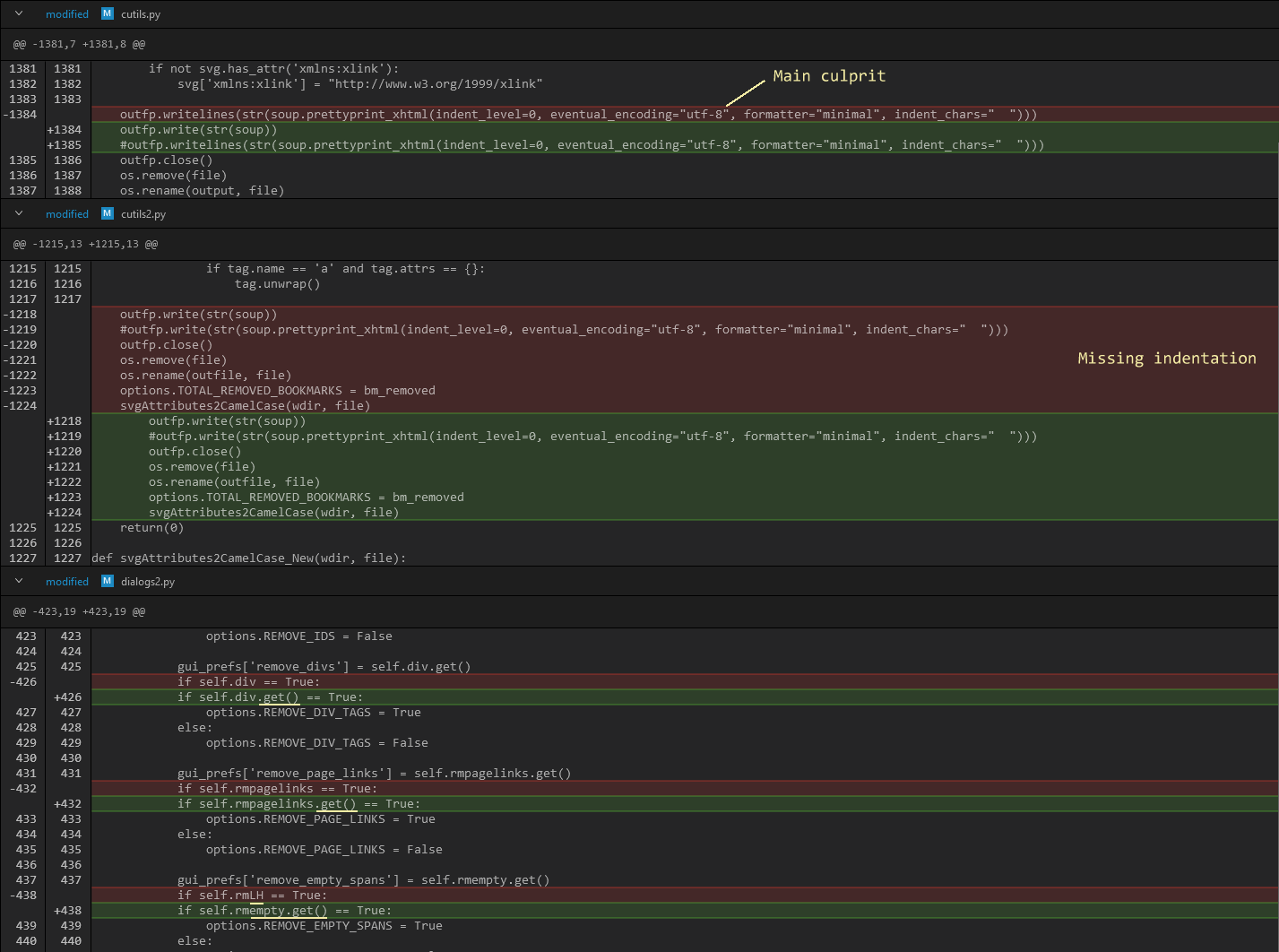

@slowsmile: Don't give up! Your plugin has potential.
I know you don't want to improve this plugin anymore, but still, I found a few bugs in it, as well as the one that caused spaces to "disappear".
The options.py file was also missing the default entry
REMOVE_EMPTY_PARAS = False
I didn't check all the features in the plugin.
I was doing a clean test on the example EPUB file attached.
I have shown my modifications in the attached image.
Note that I called this problem a "last file issue" due to the lack of indentation in the cutils2.py file.
This lack of indentation caused the last commands (including space destruction) to appear only in the last (x)HTML file. I think this was the main reason why you could not reproduce the problem described by @DNSB.
The main culprit was a single line that was saving the file and, in the process, cutting out spaces.
You do what you want with it.
From 037f91289da18d3105605c73205a50fc55b463cf Mon Sep 17 00:00:00 2001
From: BeckyDTP <becky@fr.pl>
Date: Mon, 11 Dec 2023 16:59:40 +0100
Subject: [PATCH] Fix
 cutils.py   |  3 ++-
 cutils2.py  | 14 +++++++-------
 dialogs2.py |  6 +++---
 3 files changed, 12 insertions(+), 11 deletions(-)
diff --git a/cutils.py b/cutils.py
index 98c4295..0da707c 100644
--- a/cutils.py
+++ b/cutils.py
@@ -1381,7 +1381,8 @@ def svgAttributes2CamelCase(wdir, file):
         if not svg.has_attr('xmlns:xlink'):
             svg['xmlns:xlink'] = "http://www.w3.org/1999/xlink"
-    outfp.writelines(str(soup.prettyprint_xhtml(indent_level=0, eventual_encoding="utf-8", formatter="minimal", indent_chars="  ")))
+    outfp.write(str(soup))
+    #outfp.writelines(str(soup.prettyprint_xhtml(indent_level=0, eventual_encoding="utf-8", formatter="minimal", indent_chars="  ")))
     outfp.close()
     os.remove(file)
     os.rename(output, file)
diff --git a/cutils2.py b/cutils2.py
index 830ce2b..832a686 100644
--- a/cutils2.py
+++ b/cutils2.py
@@ -1215,13 +1215,13 @@ def removeUnusedBookmarks2(wdir, t_fnames, href_ids):
                 if tag.name == 'a' and tag.attrs == {}:
                     tag.unwrap()
-    outfp.write(str(soup))
-    #outfp.write(str(soup.prettyprint_xhtml(indent_level=0, eventual_encoding="utf-8", formatter="minimal", indent_chars="  ")))
-    outfp.close()
-    os.remove(file)
-    os.rename(outfile, file)
-    options.TOTAL_REMOVED_BOOKMARKS = bm_removed
-    svgAttributes2CamelCase(wdir, file)
+        #outfp.write(str(soup.prettyprint_xhtml(indent_level=0, eventual_encoding="utf-8", formatter="minimal", indent_chars="  ")))
+        outfp.close()
+        os.remove(file)
+        os.rename(outfile, file)
+        options.TOTAL_REMOVED_BOOKMARKS = bm_removed
+        svgAttributes2CamelCase(wdir, file)
     return(0)
 def svgAttributes2CamelCase_New(wdir, file):
diff --git a/dialogs2.py b/dialogs2.py
index 105012e..00c1519 100644
--- a/dialogs2.py
+++ b/dialogs2.py
@@ -423,19 +423,19 @@ class AppDialog2(Tk):
                 options.REMOVE_IDS = False
             gui_prefs['remove_divs'] = self.div.get()
-            if self.div == True:
+            if self.div.get() == True:
                 options.REMOVE_DIV_TAGS = True
             else:
                 options.REMOVE_DIV_TAGS = False
             gui_prefs['remove_page_links'] = self.rmpagelinks.get()
-            if self.rmpagelinks == True:
+            if self.rmpagelinks.get() == True:
                 options.REMOVE_PAGE_LINKS = True
             else:
                 options.REMOVE_PAGE_LINKS = False
             gui_prefs['remove_empty_spans'] = self.rmempty.get()
-            if self.rmLH == True:
+            if self.rmempty.get() == True:
                 options.REMOVE_EMPTY_SPANS = True
             else:
                 options.REMOVE_EMPTY_SPANS = False
2.39.1.windows.1

Oh, I would be happy to check your file.
You can send me a piece via PM.
This problem is indeed not a major issue, but other fixes in the plugin are worth improving.

Looks good. Those two options no longer trigger the space removal on my test ePub.
I ran the ePub that originally triggered the issue for me through CCPlus and it also looked good. I still manually removed the <i> tags that surrounded the spaces because they were annoying.

I've put in all @BeckyBook's fixes and I've just tested the new fixed version of the plugin. I just want to clarify and confirm how the new plugin version behaves now.
When I run the new plugin with the "Remove empty spans" option selected with this epub code:
<p><span>This is a plugin test run</span></p>
The html is changed to this -- all empty spans(with no attributes) are removed:
<p>This is a plugin test run</p>
Also, if I run the new plugin with no options set and run it on this code:
<p>This <span> </span>is a plugin test <span class="P1"> </span>run</p>
I get this as a result:
I can also confirm that when I ran the same tests using @BeckyeBook's plugin version -- I got the same results.

For me, this is OK.
