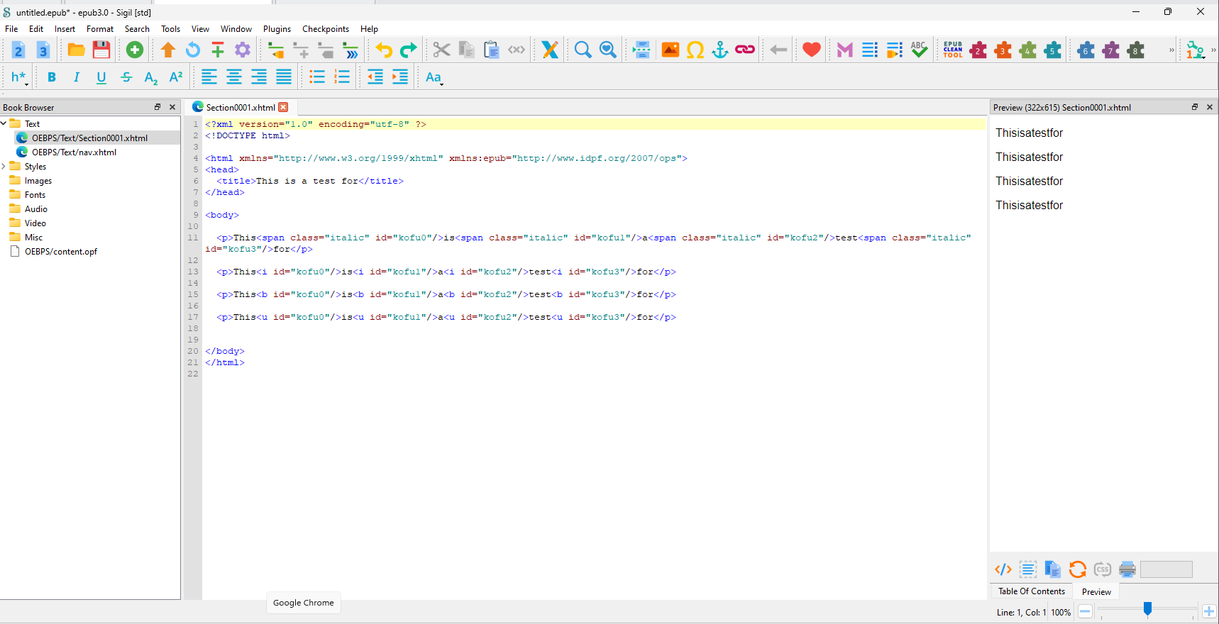

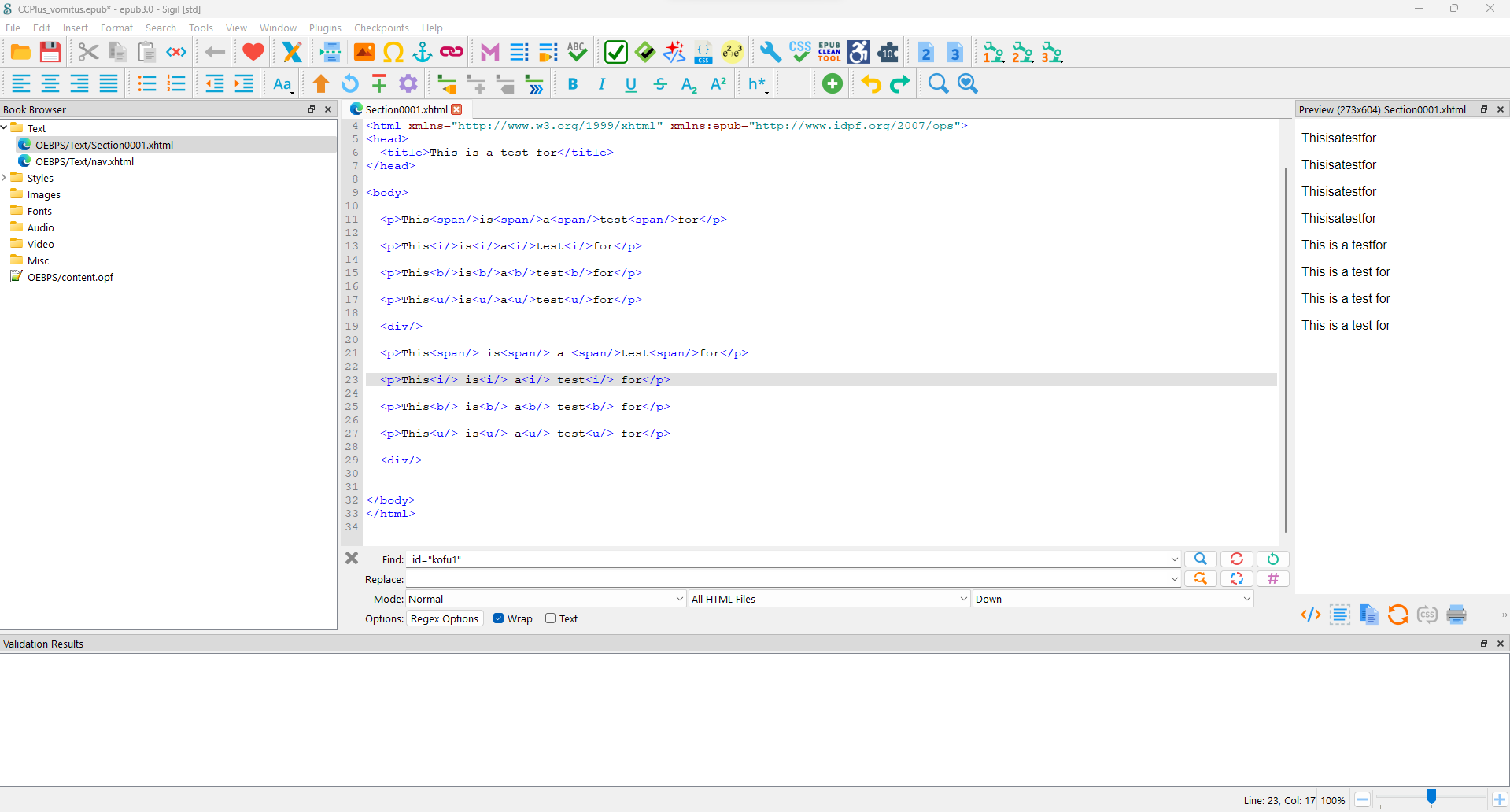

For what it's worth, I updated to v0.5.5 when it was released. As part of my testing, I also spun up several virtual machines where I installed Sigil and CustomCleanerPlus v0.5.5. I saved an epub3 version of my test line. When I ran CustomCleanerPlus on my test epub, I got the same result on all 3. No other plugins were installed on those three VMs.
Please note that this behaviour is consistent with any of the tags I tested surrounding a space and even when I tried <div> </div> which was collapsed to <div/>.
See the attached images for the before (Mac OS Sonoma 14.1.2 only) and the post CCPlus run on all three VMs.
I still believe that removing the tags and leaving the spaces would be the correct behaviour while the actual behaviour of removing the spaces and collapsing the tags in incorrect.

Just for the heck of it, I did a bit more testing by duplicating the content of the test epub, removing the classes and ids and moving the space outside the tags. Oddly, the results were pretty much the same, the tags were collapsed and not removed.
ID:	205135   Click image for larger version

@DNSB,
When I ran the plugin with no options on this simplified code:
<p>This <span> </span>is a test for</p>
After plugin run, I had this result:
<p>This <span/>is a test for</p>
In the code, notice that <span> </span> has been converted from a double tag span entity to this <span/>, which is a useless and redundant single tag span entity that does nothing. But interestingly, the test EPUB still passed Epubcheck, even though that single tag span is redundant and useless code.
And as I've also described in a previous post -- it's probably my use of python's BeautifulSoup(BS) module that's causing the double span tag with blank space to convert to single span tag format with no blank space. And nowhere in my BeautifulSoup code am I deliberately trying to convert to single tag format.
So, unfortunately, I can't fix the above problem -- because it's a BeautifulSoup problem.
I tried another simple test to confirm my findings. I added a horizontal rule with a blank space to the EPUB like this:
<hr> </hr>
Then I ran my plugin and BeautifulSoup changed the above line to:
<hr/>
. . .to single tag format - just like the span tag with blank space.
And just to clarify that the above span problem seems to be normal BeautifulSoup
behaviour for any tag like <a>, <hr> or <span> that contains just a blank space.
And, like I've said, I can't fix that problem if the cause is inside python's BeautifulSoup module. So your only option appears to be to manually remove all of those useless single tag span entities in Sigil using search and replace.
