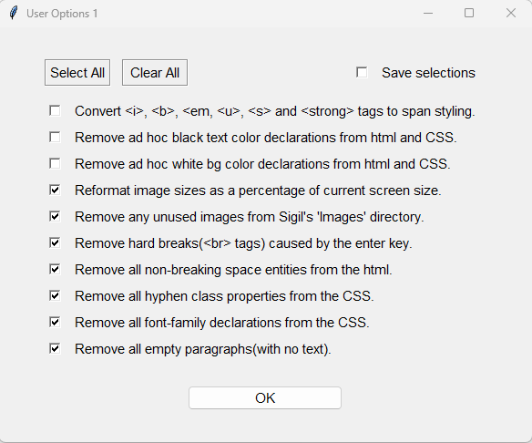

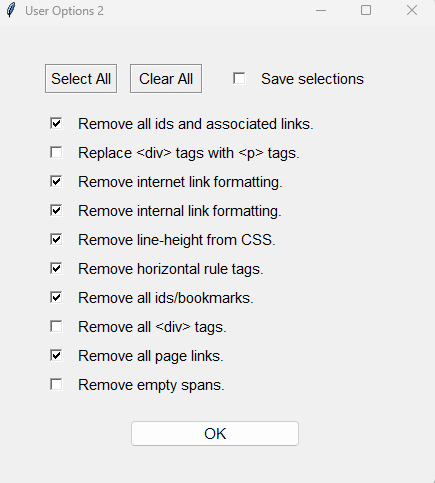

Posts: 55,259
Karma: 182532776
Originally Posted by BeckyEbook View Post
Oh, I would be happy to check your file.
You can send me a piece via PM.
This problem is indeed not a major issue, but other fixes in the plugin are worth improving.
Probably easier just to attach the file here. Oddly, I forgot to remove my default selections when I ran CCPlus 0.5.6. When I cleared all selections, the spaces weren't removed unlike with 0.5.5. The options that I've found to trigger the issue were Remove ad hoc black text color declarations from html and CSS & Remove ad hoc white bg text color declarations from html and CSS. When I ran CCPlus with the options shown in the attached images, it looked good so it appears to be those two color options that cause my issues as a second test with everything selected on the 2nd page of the options also did not cause the missing space issue.
ID:	205147   Click image for larger version
