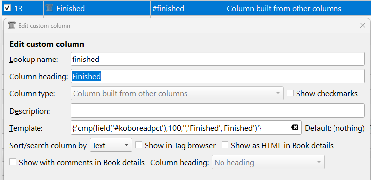

Your results are pretty much as expected. I also have a 4th column called Finished based on the reading percent column. Basically, if reading percent is 100, the column gets Finished in it.

DNSB is offline

Would you mind sharing your code for the finished column? I want to do that but no need to reinvent the wheel. Thanks.
Jon, take a look at the image in the message I posted. Yes, you will have to retype it but life is tough.
