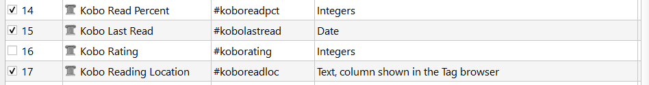

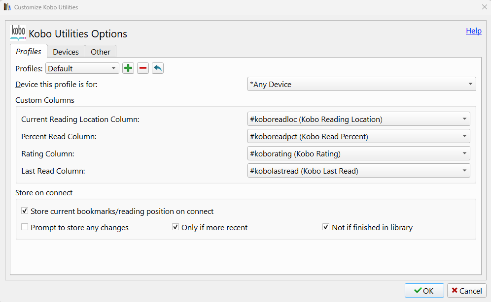

Hi,
I'm trying to get the % Read column to populate from my Libra 2, but it's staying empty.
I have enabled the column #kobo_percent_read, with Type = Integers.
I have configured 'Percent Read Column' to be #kobo_percent_read (%Read)
Under 'Store on connect' I have enabled Store current bookmarks/reading position on connect
Is there another step I'm missing?
w00dent0p is offline
Old 01-08-2024, 03:19 PM   #2826
Posts: 55,316
Karma: 182532776
See the attached images for my configuration for Kobo read statistics. Also note that I apply this to all devices since at times, a reset or firmware update breaks the link between a device in calibre and the physical device.
ID:	205677   Click image for larger version

Wow, that worked. Thank you so much.
Device this profile is for: changed to *Any Device
Prompt to store any changes: changed to unchecked
Only if more recent: changed to checked
Not if finished in library: changed to checked
Not sure what any of the last three boxes really mean, but I'm now getting blanks for unread books, 100% for read books, and X% for in progress books. Assuming this is expected?
The Prompt to store any changes will ask you if you want to store any changes. It rapidly gets painful so I turned it off.
The Only if more recent will keep the latest information in calibre. Say I connect my Sage and it says the book is 87% finished while my Clara HD says it's 74% finished, the more recent of the two would apply.
The Not if finished in library says don't update any finished books. Basically, if you re-read the book, it will not update the calibre library information. Or if you do a reset and reload, your finished books will not change to unread.
Your results are pretty much as expected. I also have a 4th column called Finished based on the reading percent column. Basically, if reading percent is 100, the column gets Finished in it.
