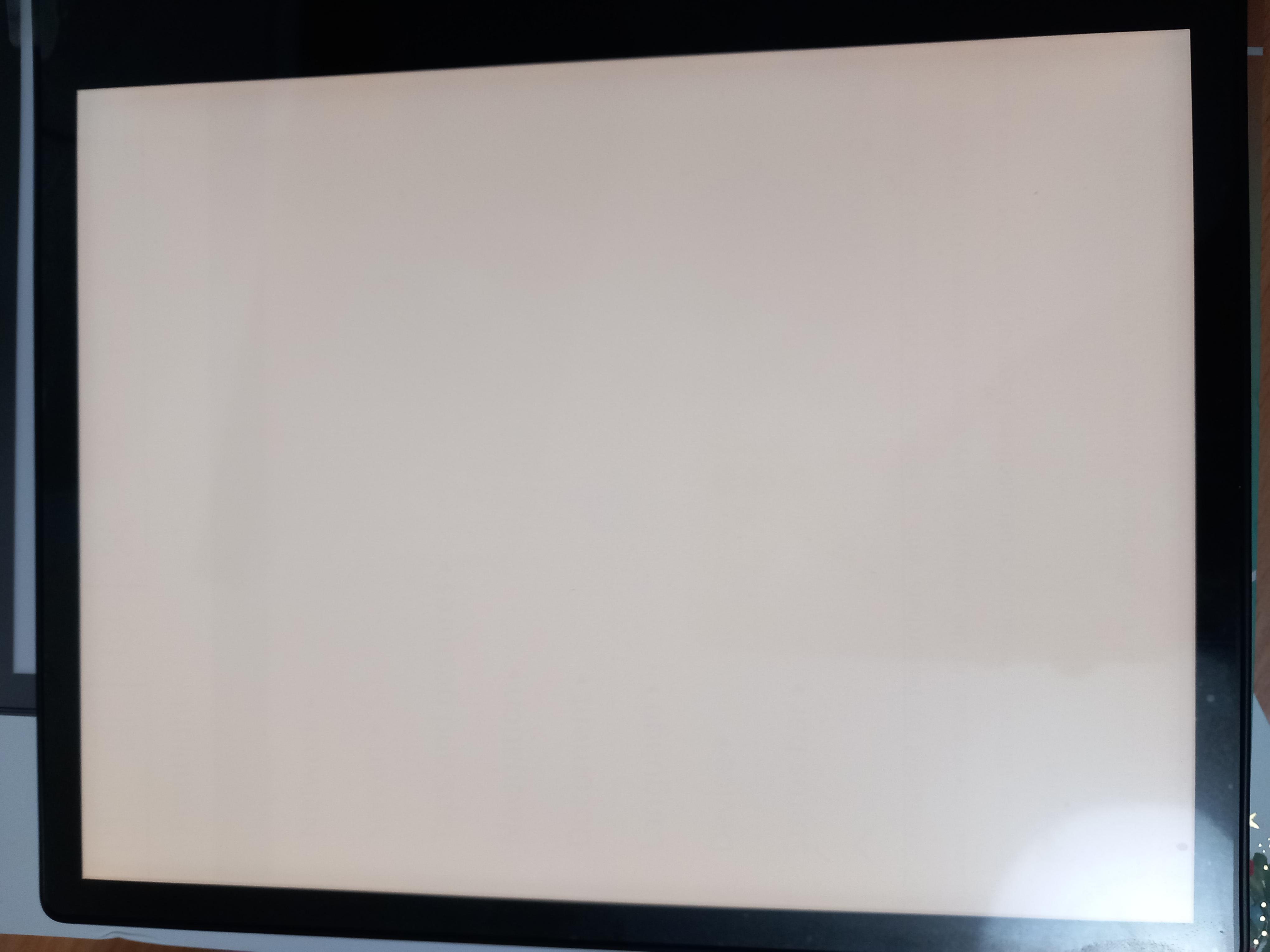

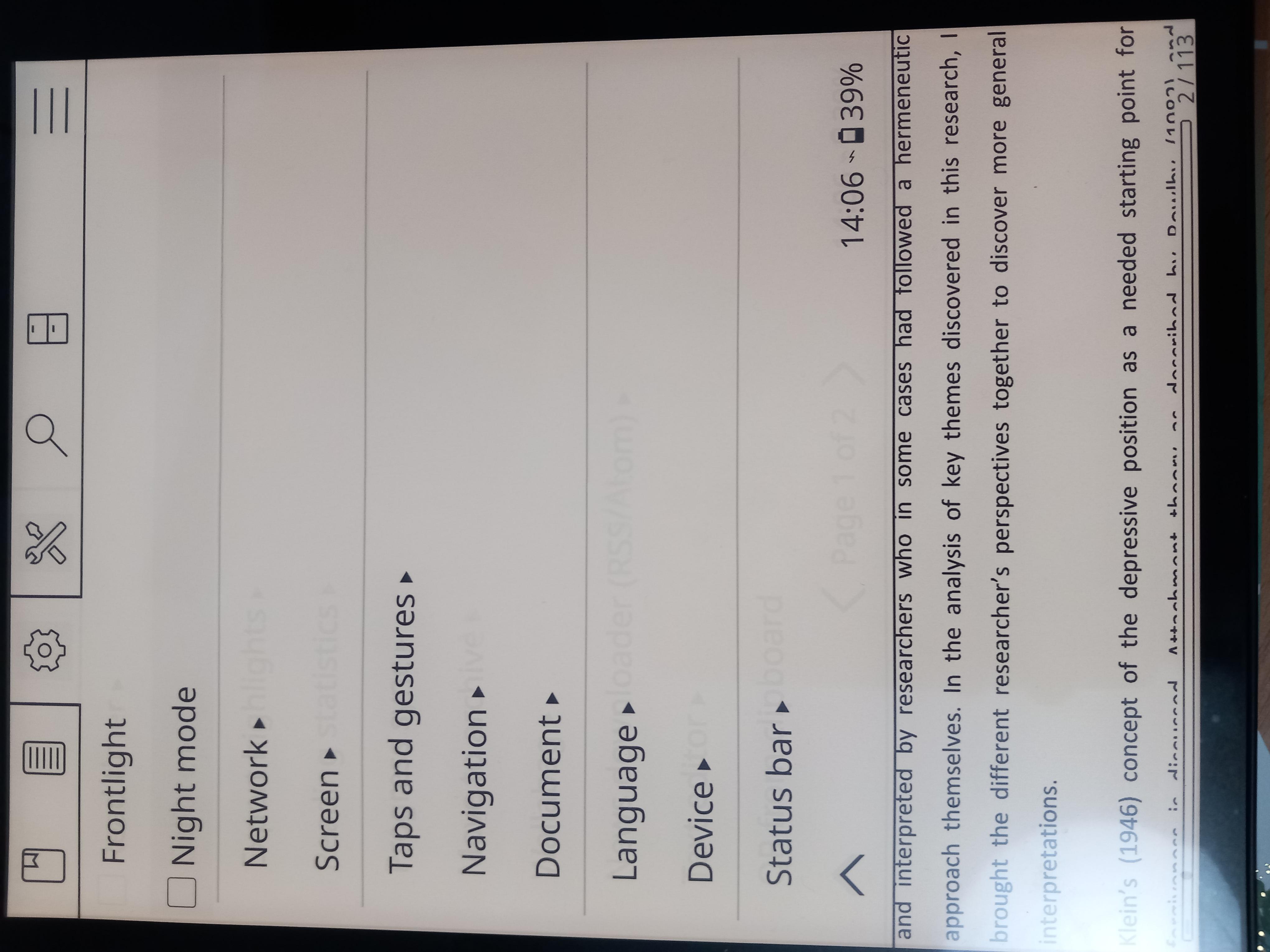

Old 12-15-2023, 10:27 AM   #990
kungfuhobbit
kungfuhobbit began at the beginning.
Join Date: Dec 2023
Device: Kobo Forma 2
Hi (thanks for your work on software)
Symptom:
Activating "Night mode" makes the screen all white.
I can deactivate it by guessing where the buttons are.
Factory reset device, reinstalled and retried. Same symptom.
Kobo Elipsa 2E
FW 4.36.21099 (a15626ed39 4/18/23)
v2023.10
Both times install.ps1 as Administrator and execution policy bypass
Windows 10 Pro 10.0.19045
No powershell errors
https://www.mobileread.com/forums/sh...96&postcount=2
I cant find usr/local/kfmon/kfmon.log or other log files on the device
Please could you help?
Is Night Mode a Beta feature?
It worked great on my Kobo Forma 2
ID:	205212   Click image for larger version
