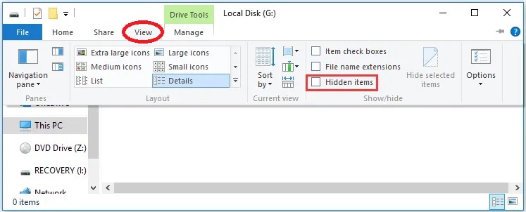

It's easiest to move the images to your device over USB however, but like I said, you won't see the system directory by default as it's hidden. To view hidden items, in Windows File Explorer:
View > Hidden Items - (see image below)
Then copy BMP images to: <whatever_drive_letter_is>\system\logo\offlogo
