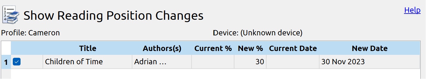

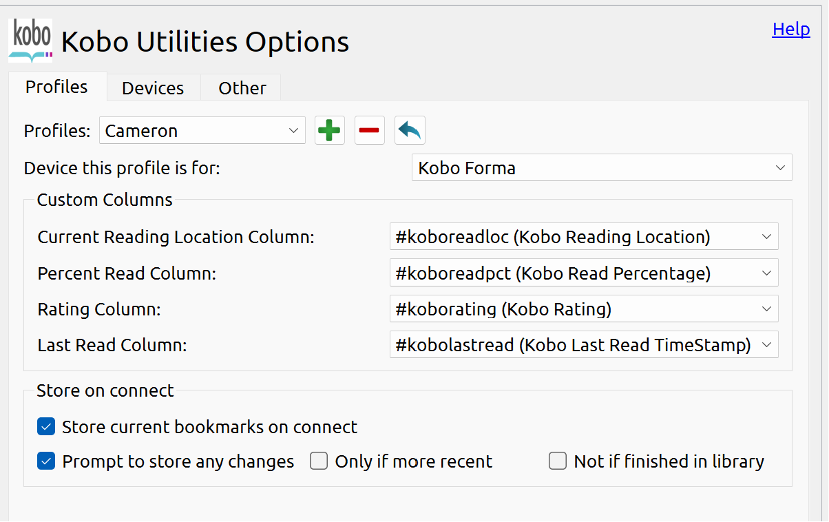

KoboUtilties Custom Columns Not Updating
Help!
I have set up 4 custom columns in Kobo Utilities to synch ReadingPercent, ReadingLocation, LastReadDate and KoboRating.
Until Version Calibre Version 7.x these updated without fail. I can no longer get the fields to update, but when I query the kobo database using Kobo Utilities "Store/Restore Current Bookmark" command the data appears in the KoboUtilities confirmationdialog box, but the calibre database does not update.
Anyone else had this problem or know of a work around?

Is it just me? Since Calibre V7.x my custom columns have stopped working (% read, rating, position and lastreaddate). The plug in can see the data from the Kobo when I use the "Store/restore current bookmark" command in the menu, but the database fields do not update. Anyone else have this issue?

Does the update work if you try setting the device to the default *Any Device setting? And perhaps change the Profile to default? There have been several reports that after firmware updates and other changes, the device is no longer seen under the device name. Ditto for the named profiles.
