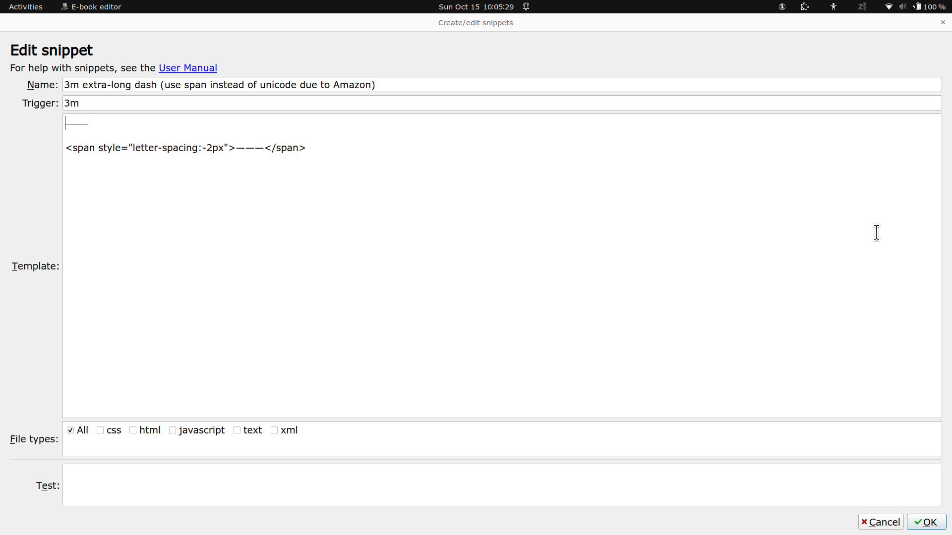

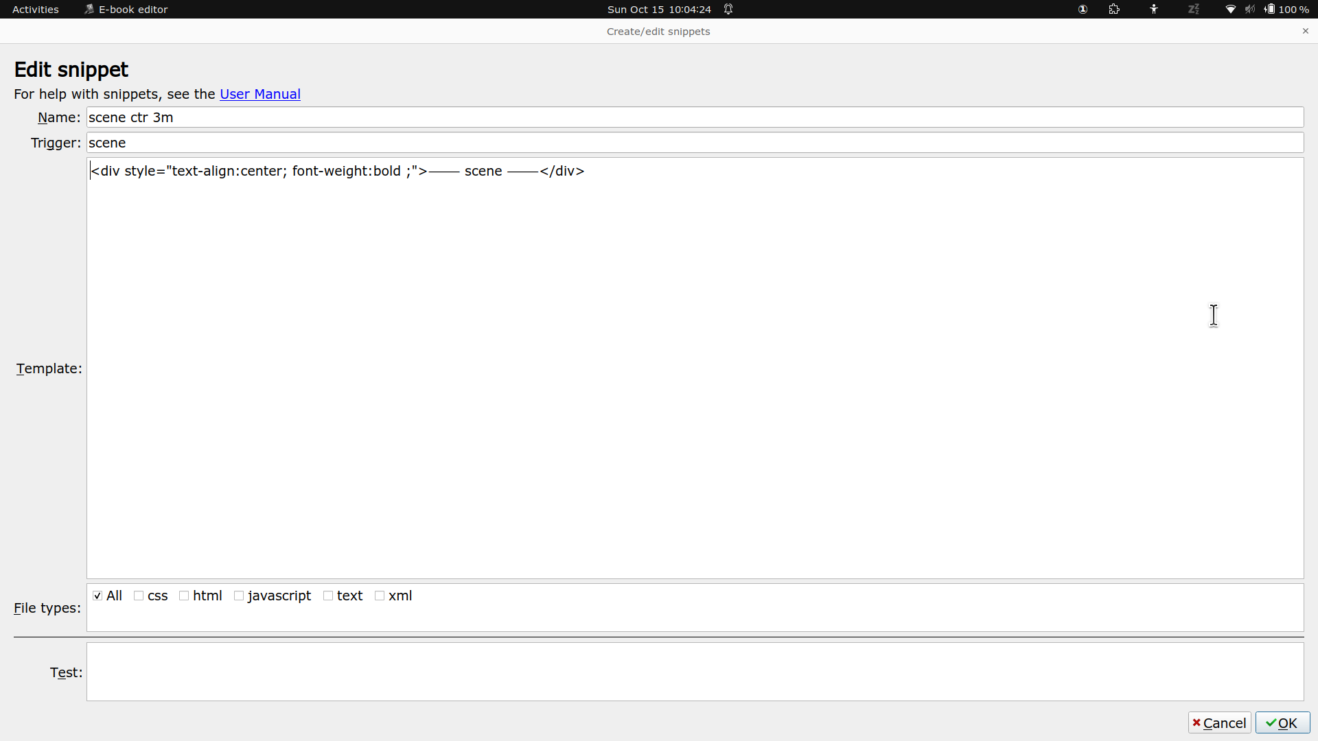

It's the extra long dash that won't show correctly in kindle previewer. I quit (more or less) using it from advice on mobileread. I now fudge the way-long dash with calibre's snippetology which is fun to do. It would be great if there were a way to insert various CSS to create epub outcomes viewable with calibre's reader that emulates what each and every name brand dedicated ebook reader will show without having to actually purchase that particular piece of hardware. I have no desire to buy any nook, fire, ipad, sony, kobo etc. in addition to my laptop which seems to show epub rules exactly under calibre. As of now, putting cutting edge CSS stuff on amazon runs the risk of it looking corrupt on their own reader. They only use a cut-down subset of CSS. As for little-used unicode stuff (which I like to goof with sporadically) I am perplexed it won't work in the amazon kindle previewer. After all, they have done yeoman's work getting Japanese, Hindi, every which kind of alphabet to work. Seems as though they could at least put out a linux version. I thank you all for your input and correspondence. Best regards, Pop

Hmmm... That could be a horizontal bar ( ― ), a 2em dash ( ⸺ ) or a 3em dash ( ⸻ ) all of which I've seen used. All too often, what gets displayed is a notdef character. The actual character will depend on the font, some common examples in the attached graphic. Others may be used depending on what is set for glyph 0 in the font.

I use the triple dash like this for mid-chapter centered scene breaks: em dash space scene space em dash.
No. The two rare dash characters:
  • U+2E3A = ⸺ = TWO-EM DASH
  • U+2E3B = ⸻ = THREE-EM DASH
should not be used like that.
Instead, it's better to create those lines via CSS. That was one of the first questions I asked MobileRead wayyyy back in:

I also strongly recommend against using those 2 dash characters, because of all the missing font + problematic rendering issues. Instead, use the equivalent amount of normal EM DASHes.
Yep, exactly. Barely any fonts have those 2 rarer dash characters, and it will cause more trouble than it solves.
