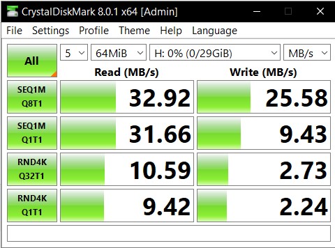

Edit: I did some tests with CrystalDiskMark on both the Clara HD and Libre 2 .
The write speeds for the last two rows are closer to what I get transferring many epubs. Although 2.7-3.0 MB/s is still the maximum I can get even if it's one large file (like a KoboRoot.tgz).
ID:	202021   Click image for larger version

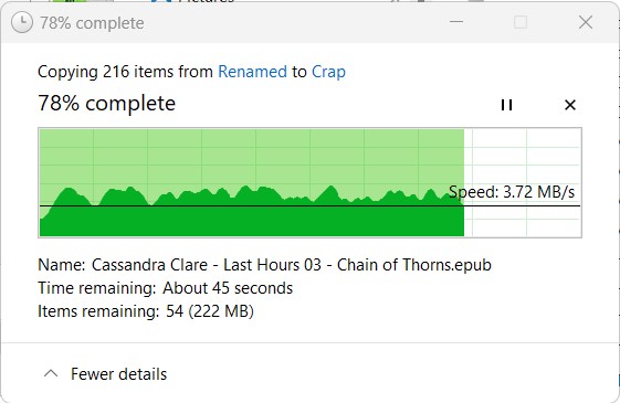

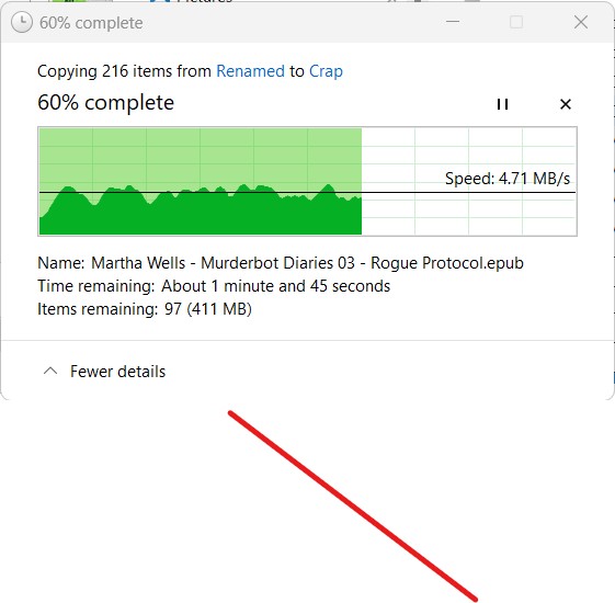

Old 06-14-2023, 05:26 PM   #13
Posts: 80,855
Karma: 150249631
This is copying about 1GB worth of random eBooks to my Libra 2 from SSD to the Libra 2 via USB-C to USB-C in Windows 11 using Windows Explorer. I'm getting about 3M to about 6MB.
Name:	Screenshot 2023-06-14 212338.jpg
ID:	202025   Click image for larger version
Name:	Screenshot 2023-06-14 212327.jpg
ID:	202026   Click image for larger version
Name:	Screenshot 2023-06-14 212307.jpg

250 random eBooks copied to my Libra 2 same way as the previous message took an average of 4.31MB to copy.
1,245,760,356 bytes took 4:35.29 to copy.
