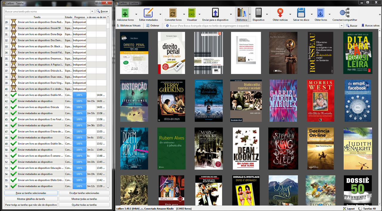

Having this problem as well with slow metadata uploads to my kindle. Also It updates the metadata after each book wich makes it take a very long time to upload many books to my device. Few seconds for the book upload, 3 minutes for the metadata to update. Is there a way to send all the books and update the metadata just once? It takes 12 hours to send 330 books to my device. It's a pain. Any advice?

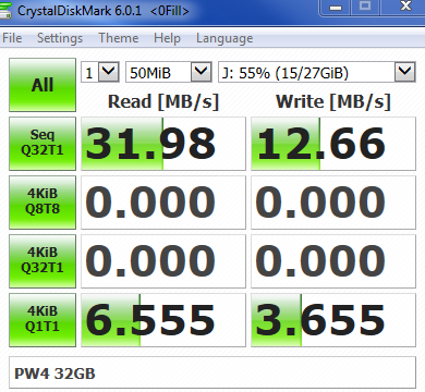

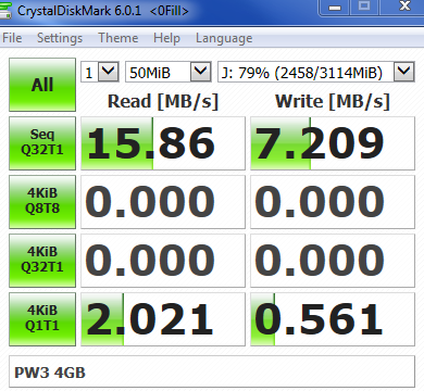

Originally Posted by alexter View Post
No Antivirus here. Nothing out of order runing in the background. I can also transfer files between HDs on my box at 140MB/s. Using an i7 with 16GB ram. Also I'm using a USB2.0 port wich gives me 30MB/s transfer rate to any external drive I use on it. Also I'm sending the books as a batch, selecting all the books I want and using the "send to main memory" option.
Am I doing something wrong here?
That's probably 140MB/s large file, sustained (or RAM cached).
Try doing very short sequential and random write (1 pass 50MiB, Q31T1 and 4KiB Q1T1) tests on your ereader's storage or SD card with CrystalDiskMark. That's most likely where the bottleneck is.

We're not saying your PC storage is slow.
We're saying the e-reader/Kindle onboard storage is slow (see attached benchmark results for my PW3 and PW4).
Also, transferring 2,200 2MB ebooks takes longer than transferring a single 4.4GB file.
Calibre doesn't divide my send to device jobs into multiple tasks. Are you converting ebooks as you send? If I were you, I'd just run a batch conversion job and do the send to device afterwards.

The metadata.calibre is held off until the CURRENT batch is done.
Not what is happening here. If the book is not pre converted to mobi it sends the metadata after each book convert and upload, just take a look at the screenshot I've posted earlier. After I convert the books as a batch it sends all the books at once and then it sends the metadata.
