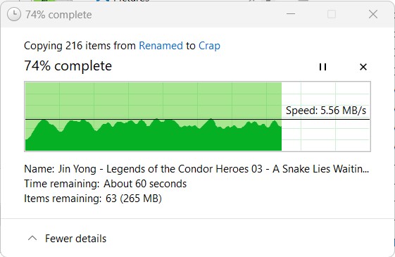

This is copying about 1GB worth of random eBooks to my Libra 2 from SSD to the Libra 2 via USB-C to USB-C in Windows 11 using Windows Explorer. I'm getting about 3M to about 6MB.

There is no way the memory inside an e-reader is fast enough to take advantage of USB 3 transfer speeds. If the transfer is fast at first and then slows down, it's probably because the computer was transferring books into a buffer, and once the buffer filled up, it had to slow down to wait for the buffer to empty at the real transfer rate.
Old 06-14-2023, 04:38 PM   #15
Posts: 85,341
Karma: 154365103
250 random eBooks copied to my Libra 2 same way as the previous message took an average of 4.31MB to copy.
