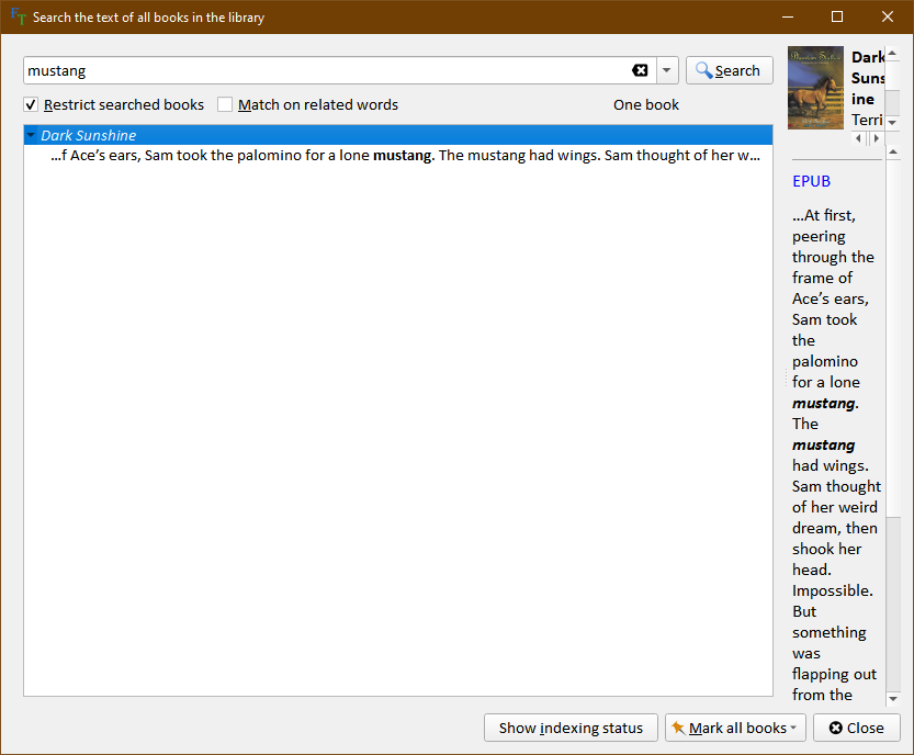

UI thought: There ought to be a resizable divider between the search results and preview pane. Currently, the right preview pane is a little squished unless I maximize the window:

Also, the tooltip indicates that 'restrict searched books' should search all the books currently in view. Instead, it only searches currently selected books.
It might also make sense to have a menu option to manually reindex selected books.

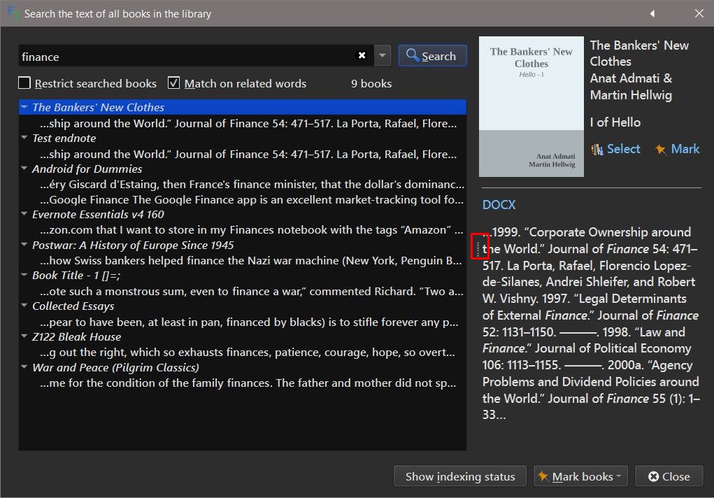

That's odd, i get a splitter handle halfway down the panel, viz:

Oh, I found it now that it's mentioned. I miss my dark mode.

And the tool tip for the Restrict searched books checkbox text seems pretty clear to me:
Restrict search results to only the books currently showing in the main library screen. This means that any Virtual libraries or search results are applied.
But maybe something like: "Only search the text of the books that are currently shown - i.e. books in the current VL and within the current metadata search constraints." would be more explicit.

In my case, it only searched the one book I currently had selected. I had several other books visible in the list that had 'mustang' in the text, but only the selected one showed up.
I'm running from source, if ifthat's any matter.

Gotcha - it's the same for me if I select a book or some books.
How can you unselect the current book… other than a library switch of some sort?

I think I'd prefer 3 radio buttons - search selected books, search within current VL and metadata search criteria, and search the entire library.

restrict books was not supposed to work on selected books, but rather all currently shown books, this was a bug, now fixed.

Released 5.99.11 which uses pdftotext for indexing pdfs which is much faster and also gives better results for PDFs that are scanned pages with a text layer. Also fixes the issue with restrict searched books restricting to selected instead of displayed books.
