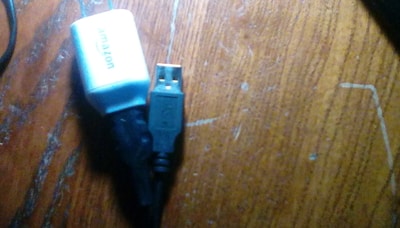

For a while, I haven't been able to connect my Kindle Paperwhite 2 to my computer. Or any computer. This is frustrating because I have files I want to read on it. I can't transfer these over wifi because they're too large. And I can't transfer with USB because it's not showing up.
I've tried lots of things. Resetting my computer (which runs Windows 10) and Kindle multiple times, including a hard reset. I've changed selective suspend settings. I've uninstalled and reinstalled the USB controllers. I've tried lots of different cords. I've tried connecting my Kindle using those lots of different cords to different computers. Some of those cords were working with my Kindle just a month ago.
No matter what I've done, it still won't show up in the files Any suggestions?

I've had the same problem with my kindle fire not connecting and tried much of the steps you listed as well and nothing worked. I'm thinking about getting a can of compressed air to clean out the usb port in case some debris is in there but otherwise I'll just wait. Another idea I had is to update the firmware to see if that will also help with connectivity issues. As far as getting your files on you paperwhite I'm assuming you got most of those files are from the internet. You might try to use the experimental browser to download some of those files directly to your paperwhite.

Surely frustrating. Checking the cable & trying a different PC were the logical things to check first. If you have shell access - or want to jailbreak & install USB networking that may be a good way to transfer files over USB.
If the USB connector on the Kindle is loose or damaged though you need to remedy that first.

well it doesn't seem to be anywhere in that log.
it's looking like the usb port is faulty, either a damaged pin in the socket or a failed connect to the motherboard, but the pins needed for charging are OK.
replacing that socket probably requires mucho soldering skills.
if it were me, I'd call a amazon in the hope of being offered an attractive discount on a trade in for new or refurbished PW 3 or 4, and take that. The PW 3 was a significant improvement, screen-wise over the PW2
I dont see any mention of the time - honoured jiggle it about until it works trick, but thats more for loose connections that will still work only at certain angles
squirt some switch cleaner into the socket if you have any but that's a real long shot ( or WD40 if desparate )

Funny how one thing leads to another. I ran the command and although nothing connected I heard the dinging sound. Although I already swapped different cables I decided to swap out one more cable and it connected. Turns out the previous cables were charging cables. I never paid attention to these cables before but upon closer inspection there is a difference between a charging cable and the connecting cable. So, I went ahead and wrapped a piece of white tape around the charging cable to tell it apart from the connecting cable. Visually, it is also easier to tell apart because the usb section of the charging only cable is "thicker" than the narrower connecting cable. In the pic below the charging cable is connected to the amazon charger next to the "skinny" connecting cable. Running the linux command gave the following data:

Effective troubleshooting needs to be methodical. Assuming that an item works is a cardinal sin e.g. cables are a common failure point, so one should actually test the cable on another device and observe it to work before concluding that it is good.
Glad you figured it out.
