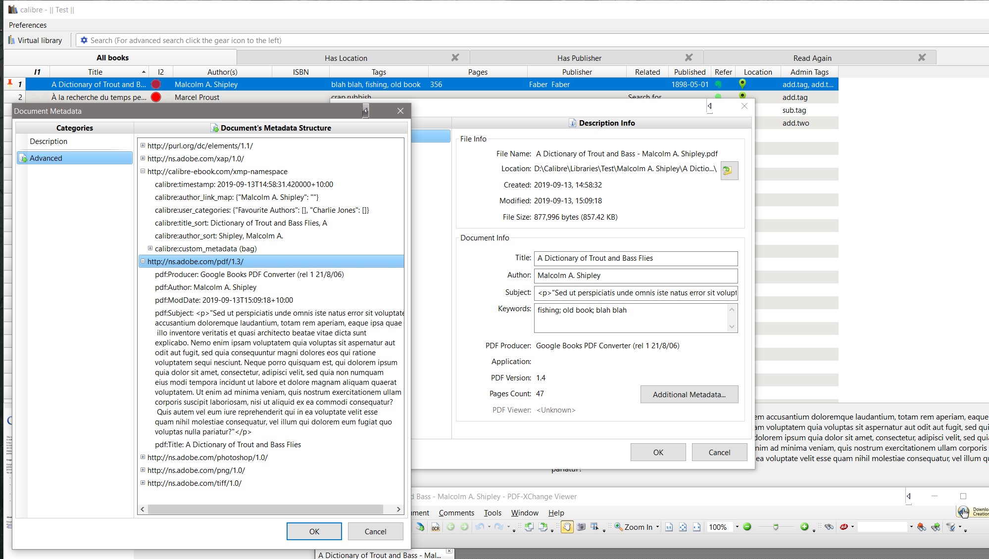

Originally Posted by tomx2 View Post
works for me viz:
Name:	Annotation 2019-09-13 151717.jpg
But metadata in PDF's is limited, you won't find any 3rd party pdf readers that can 'decipher' calibre custom columns.
I think you need to ask why in a Moon Reader+ support forum, you might find something here ==>> MR Android Devices -
I am unable to (so far) find where to view this info. From the image above, it looks as if i should go to "preferences" "all books"? and then "document metadata"? still searching...
-t
The topmost windows in my screen shot are not from calibre, they're from PDF Xchange - they demonstrate that the calibre Embed tool does inject the calibre metadata into PDF's, The question is: can your android pdf reader display the metadata?
I tested it on my phone, and my no-frills minimalist bespoke pdf reader only shows the title and author, which is adequate for my purposes.
