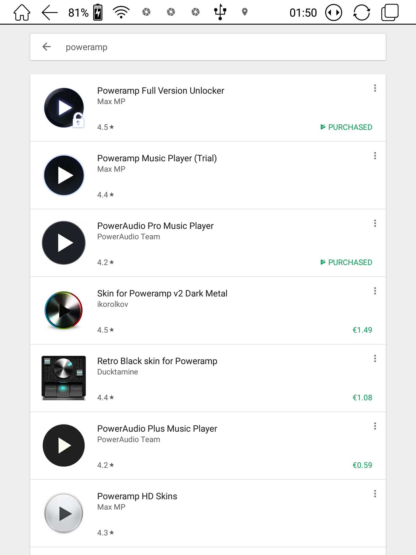

Originally Posted by shah_ram View Post
they are using Google drive really?
Did you guys find any solution for paid Apps in Google Play store?
Yes, i put some messages up.
Battery mode in no saving mode
Unfroze google setings and play store
Execute play store and login
Settings/apps/ gsf register
Apps/Play Store Login Patcher (Download from onyx store) Apply
Reboot device
Wait 5 minutes before enter play store. I don't know if it's needed but it's what it says after patching
Now you can install buyed apps.
