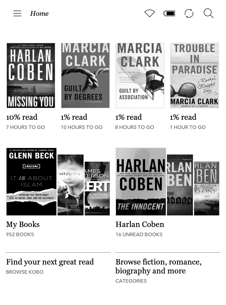

The patch `row1col2-test` works well for me it remove the author collection from row one, and it show and open other books, can you test it again.
At least one good thing come out of it, I find the way to remove the footer.

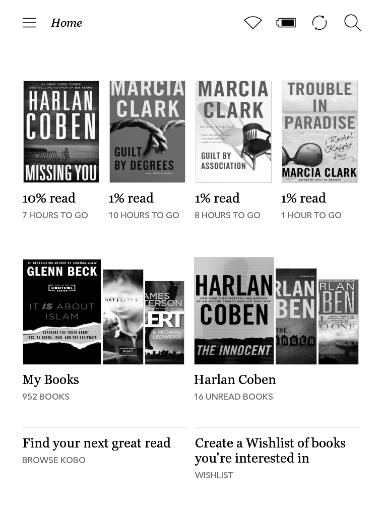

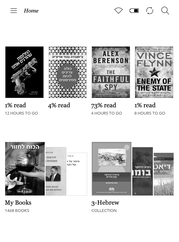

Pictures:
1. Unpatched
2. Patch`New home screen increasing cover size`
3. Patch`New home screen removing the footer (row3) and increasing cover size`
