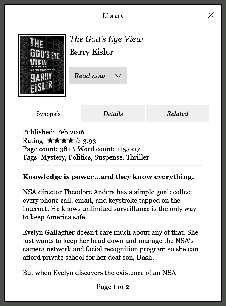

Patch to `Increasing The View Details Container`
Firmware 4.2.8810+, the patch is integrated in GeoffR patcher, nickel.patch.
Firmware 4.1.7729: nickel.patch, See CSS nickel patch.

Firmware 4.0.7523: nickel.patch, See CSS nickel patch.

Multi-version patch: 3.17.0-3.19.5761+ libnickel.so.1.0.0.patch.
<Patch>
patch_name = `Increasing The View Details Container`
patch_enable = `yes`
find_base_address = `qproperty-topMargin: 0;\n\tqproperty-leftMargin: 20;`
#<<Bottom margin top container >>
# Touch
#replace_string = 0050, `qproperty-bottomMargin: 10;`, `qproperty-bottomMargin: 05;`
# Glo\Aura
#replace_string = 00ED, `qproperty-bottomMargin:15;`, `qproperty-bottomMargin:10;`
# Aura HD\H2O & Glo HD
#replace_string = 0188, `qproperty-bottomMargin: 20;`, `qproperty-bottomMargin: 15;`
#<<reducing the book Info>>
# Touch
replace_string = 01D9, `min-height: 300px;`, `min-height: 200px;`
replace_string = 01ED, `max-height: 300px;`, `max-height: 200px;`
#Glo\Aura
replace_string = 0233, `min-height: 390px;`, `min-height: 230px;`
replace_string = 0247, `max-height: 390px;`, `max-height: 230px;`
replace_string = 028C, `min-height: 550px;`, `min-height: 400px;`
replace_string = 02A0, `max-height: 550px;`, `max-height: 400px;`
find_base_address = `#details[qApp_deviceIsTrilogy="true"]`
#<<Increasing the details (text) Container>>
# Touch
replace_string = 0029, `min-height: 292px;`, `min-height: 390px;`
replace_string = 003D, `max-height: 292px;`, `max-height: 390px;`
# Glo\Aura
replace_string = 007C, `min-height: 365px;`, `min-height: 515px;`
replace_string = 0090, `max-height: 365px;`, `max-height: 515px;`
replace_string = 00CE, `min-height: 560px;`, `min-height: 710px;`
replace_string = 00E2, `max-height: 560px;`, `max-height: 710px;`
</Patch>
Version patch: 3.13.1, libnickel.so.1.0.0.patch.
<Patch>
find_base_address = `#bookInfoWidget[qApp_deviceIsTrilogy="true"]`
# Touch
replace_string = 0030, `min-height: 256px;`, `min-height: 200px;`
replace_string = 0044, `max-height:256px;`, `max-height:200px;`
#Glo\Aura
replace_string = 008A, `min-height: 320px;`, `min-height: 230px;`
replace_string = 009E, `max-height:320px;`, `max-height:230px;`
# Aura HD\H2O
replace_string = 00E3, `min-height: 440px;`, `min-height: 320px;`
replace_string = 00F7, `max-height:440px;`, `max-height:320px;`
#<<top margin details (text)>>
# Touch
replace_string = 013E, `qproperty-topMargin: 32;`, `qproperty-topMargin: 10;`
# Glo\Aura
replace_string = 018C, `qproperty-topMargin: 40;`, `qproperty-topMargin: 20;`
# Aura HD\H2O
replace_string = 01D9, `qproperty-topMargin: 50;`, `qproperty-topMargin: 30;`
# Touch
replace_string = 021D, `min-height: 292px;`, `min-height: 390px;`
replace_string = 0231, `max-height: 292px;`, `max-height: 390px;`
# Glo\Aura
replace_string = 0270, `min-height: 365px;`, `min-height: 515px;`
replace_string = 0284, `max-height: 365px;`, `max-height: 515px;`
# Aura HD\H2O
replace_string = 02C2, `min-height: 560px;`, `min-height: 760px;`
replace_string = 02D6, `max-height: 560px;`, `max-height: 760px;`
find_base_address = `#ratingContainer[qApp_deviceIsPhoenix="true"]`
#<<Canceling the rating container>>
# Glo\Aura
replace_string = 0064, `min-height:45px;`, `min-height:00px;`
replace_string = 007B, `max-height:45px;`, `max-height:00px;`
#replace_string = 0092, `qproperty-bottomMargin: 5;`, `qproperty-bottomMargin: 0;`
# Aura HD\H2O
replace_string = 0113, `min-height:70px;`, `min-height:00px;`
replace_string = 012A, `max-height:70px;`, `max-height:00px;`
#replace_string = 0141, `qproperty-bottomMargin: 25;`, `qproperty-bottomMargin: 0;`
</Patch>
Notes:
I only try this patch on my Kobo Glo FW 3.13.1, if there is overlapping or the text is cut, you can change the values in the patch.
The information at the top (Published, Rating,...), was add by Kobo Utilities Template editor.
ID:	148578 Click image for larger version
oren64 is offline   Reply With Quote
