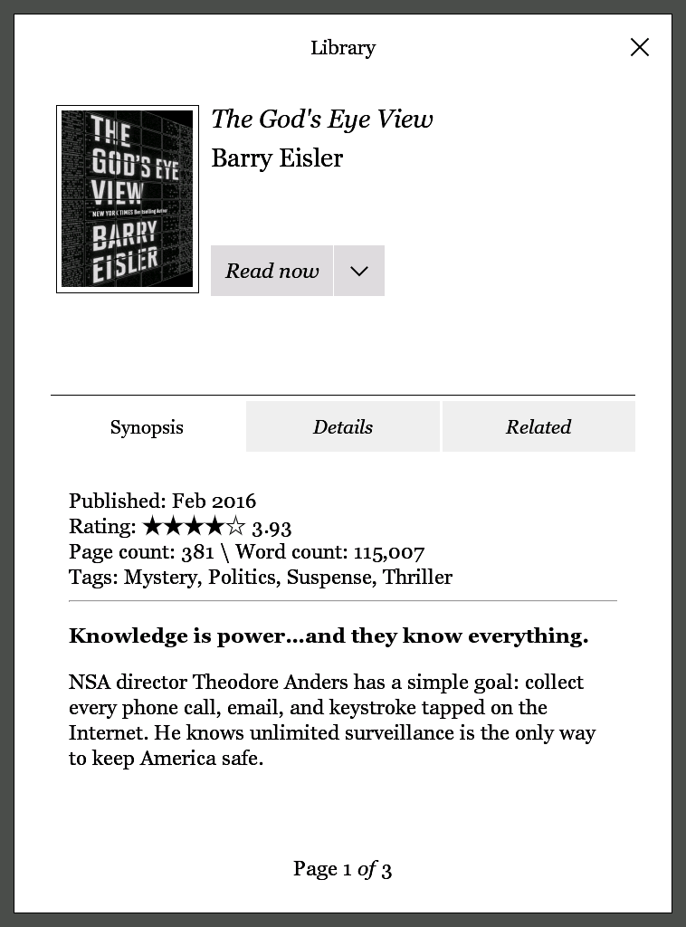

Patch to `Increasing The View Details Container`
Firmware 4.2.8810+, the patch is integrated in GeoffR patcher, nickel.patch.
Firmware 4.1.7729: nickel.patch, See CSS nickel patch.

Firmware 4.0.7523: nickel.patch, See CSS nickel patch.
<Patch>
patch_name = `Increasing The View Details Container`
patch_enable = `yes`

Multi-version patch: 3.17.0-3.19.5761+ libnickel.so.1.0.0.patch.
<Patch>
find_base_address = `qproperty-topMargin: 0;\n\tqproperty-leftMargin: 20;`

#<<reducing the book Info>>
# Touch
replace_string = 01D9, `min-height: 300px;`, `min-height: 200px;`
replace_string = 01ED, `max-height: 300px;`, `max-height: 200px;`
#Glo\Aura
replace_string = 0233, `min-height: 390px;`, `min-height: 230px;`
replace_string = 0247, `max-height: 390px;`, `max-height: 230px;`
# Aura HD\H2O & Glo HD
replace_string = 028C, `min-height: 550px;`, `min-height: 400px;`
replace_string = 02A0, `max-height: 550px;`, `max-height: 400px;`
find_base_address = `#details[qApp_deviceIsTrilogy="true"]`
#<<Increasing the details (text) Container>>
# Touch
replace_string = 0029, `min-height: 292px;`, `min-height: 390px;`
replace_string = 003D, `max-height: 292px;`, `max-height: 390px;`
# Glo\Aura
replace_string = 007C, `min-height: 365px;`, `min-height: 515px;`
replace_string = 0090, `max-height: 365px;`, `max-height: 515px;`
replace_string = 00CE, `min-height: 560px;`, `min-height: 710px;`
replace_string = 00E2, `max-height: 560px;`, `max-height: 710px;`

Version patch: 3.13.1, libnickel.so.1.0.0.patch.
<Patch>

Notes:
I only try this patch on my Kobo Glo FW 3.13.1, if there is overlapping or the text is cut, you can change the values in the patch.
The information at the top (Published, Rating,...), was add by Kobo Utilities Template editor.
ID:	148578 Click image for larger version
