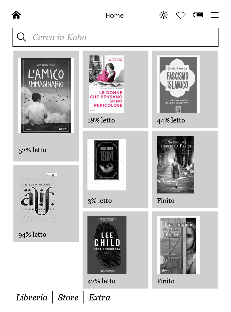

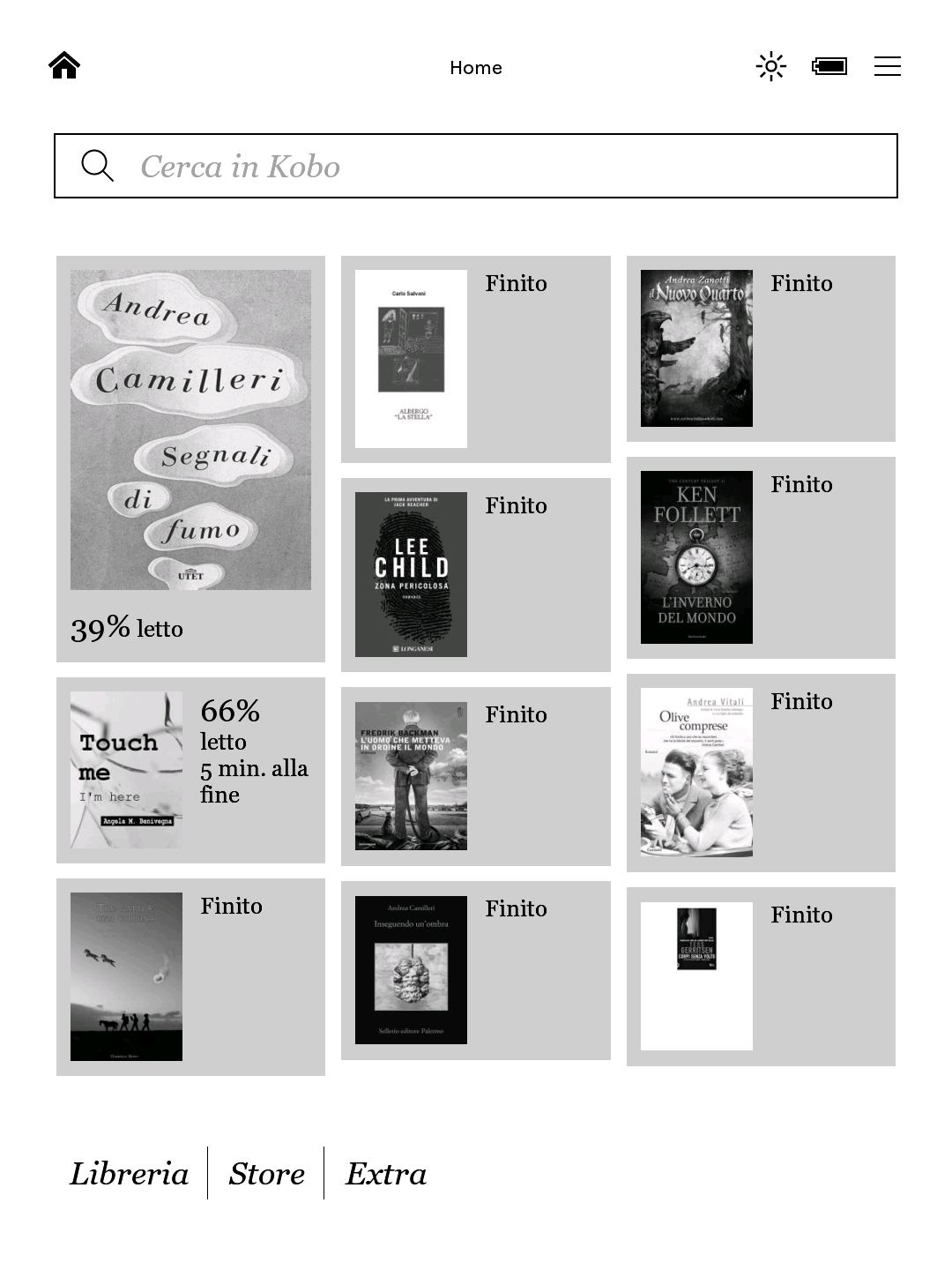

Old 11-08-2014, 04:43 AM   #141
Cesco
Cesco can illuminate an eclipseCesco can illuminate an eclipseCesco can illuminate an eclipseCesco can illuminate an eclipseCesco can illuminate an eclipseCesco can illuminate an eclipseCesco can illuminate an eclipseCesco can illuminate an eclipseCesco can illuminate an eclipseCesco can illuminate an eclipseCesco can illuminate an eclipse
Cesco's Avatar
Posts: 52
Karma: 8236
Join Date: Jul 2013
Location: Italy
Device: Kobo Aura 2-Aura H2O-K1-LibraH2O
I can make a patch for the HD/H2O, but I don't know what the current homescreen layout looks like on those devices.
The original Glo and Aura layout had a large gap at the bottom of the tiles, so it took only a fairly small change to make room for an extra row of book tiles. Unless the other devices have that large gap too, there might not be any benefit from a patch.
Thanks for your time GeoffR, this you can see in the annex, is the result of the tests (Glo patched and unpatched Aura HD) that I made using kobo utilities, so I think it is not possible to add new tiles.
ID:	130758   Click image for larger version
