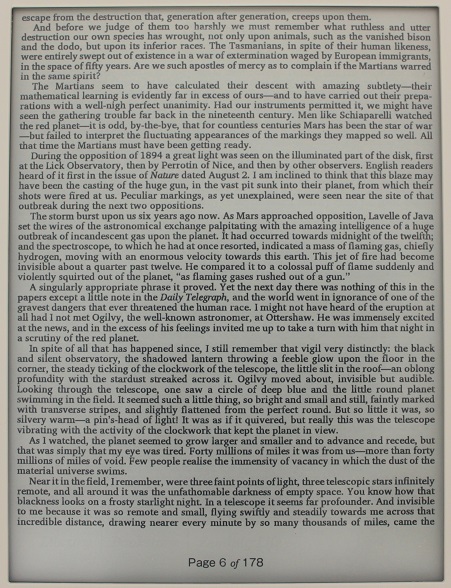

I do have widows and orphans both set to 0 in the body CSS style. Could this be another case of lets ignore it in the body style?
In the v1 sample, there is just 1 line left of the paragraph. It would have easily fit on the screen.
I'll try putting the widows and orphans in the p style and post v1 again for another sample look.
Should have included a picture of the next page without the chapter header as well for V1, the top line is a bit too close to the top of the screen for my likely but everyone's preferences are different. There are also the odd spot where the characters on one line look to touch characters on another line with the line spacing set so low, but doesn't happen that much and doesn't make it difficult to read.
Edit : I went through the whole book and there is one place where you end up with just three lines on a page (p. 25) not sure those three lines could fit on the previous page if widows 0 and orphans 0 settings were working as expected, there is one other place where there are just 4 lines on the page (p. 97) they for sure would not fit on the previous page unless they went over top of the page numbers at the bottom. so at most I think you might save one page turn in the whole book, not sure it would be worth the effort.
The page numbering is also a bit strange, going from page 6 to page 9 and then page 11 etc. There is no page 7, 8 or 10.

And I still see the "long paragraph" and "one page break before the last paragraph at the end of random chapters" bug.
The "long paragraph" etc. bug should be fixed with those settings. I tested it months ago with problematic books and haven't it experienced it since I added it to my conversion patterns.
I add this to the CSS in Calibre but am curious - does this give you full lines right to the bottom of the screen on every page? I still see some pages with one blank line at the bottom.
You can't claim the full screen space in the original reader app. You have always a wasted space at the bottom that is about as big as the menu bar you get when tapping the screen.
If you want real full screen text, there is a port of the kindlepdfreader in the devforum, which offers it. Sadly it's not based on the newer version which is better suited for touchscreen devices, but it's useable.
Quite possible, that's why I add it to <p> aswell, Kobo css interpretation is a bit temperamental/weird at times.
Edit : I went through the whole book and there is one place where you end up with just three lines on a page (p. 25) not sure those three lines could fit on the previous page if you used widows 0 and orphans 0 settings, there is one other place where there are just 4 lines on the page (p. 97) they for sure would not fit on the previous page unless they went over top of the page numbers at the bottom. so at most I think you might save one page turn in the whole book by using widows 0 and orphans 0, not sure it would be worth the effort.
The example is a well formatted book.
If you have one with bad formatting you might end up with the few lines per page bug every 10 pages or so. It happens very rarely and the book must be really screwed up, but it can happen.
The real benefit is for me that you usually get one or two lines text more on the screen with the value set, then otherwise.
My Kobo Glo has never ignored it in the body style - at least not on any of the fw versions I've used to date. One can never assume what might happen in future Kobo releases though...
The oddity you pointed out is a fairly typical, but totally unpredictable (at least by me), quirk. So I guess my experience is different from ewphoenix123 in this respect. I know that my epubs are well-formatted but I still get 'one-line gaps' at the end of some pages even when the end of the paragraph will easily fit.
I'll try adding p {widows: 0; orphans: 0} as well but I'm not convinced it will fix anything. I'm quite happy to be wrong.
Edit: I did try it and the results don't look to be any different from just having body {widows: 0; orphans: 0} YMMV

I'd really like to see a page with a font setting that allows around +/- 65 characters per line, using only the the e-reader itself for setting the line height.
Also, I really like to know if that page display can be disabled. It wastes too much space on screen IMHO.
