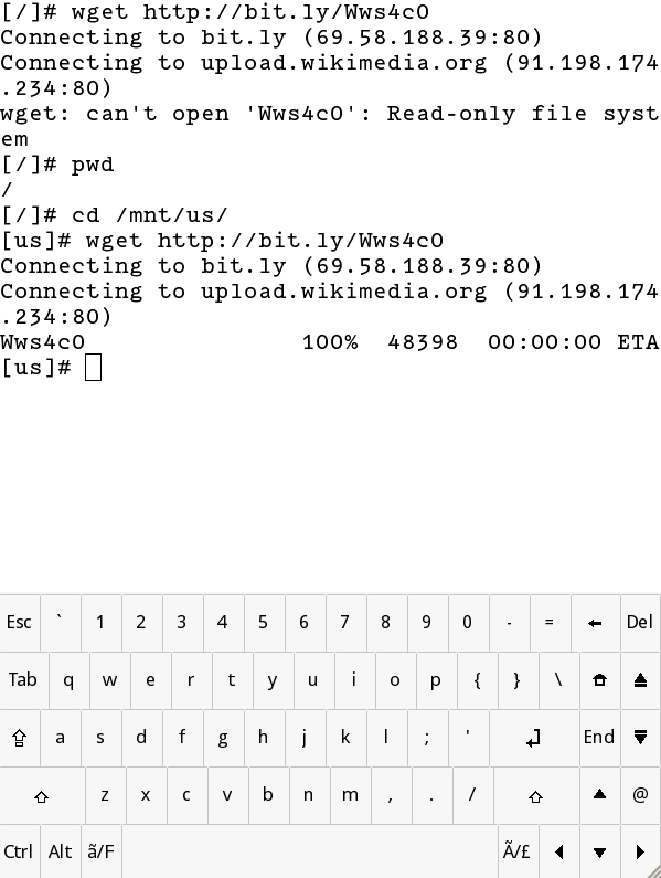

how to use the " useful terminal programs" in your website like elinks or wget???
i opened them in kterm but they seems can not resolve the url.
what should i do??

you got wifi turned on right?
because I just tested it. seems okay.?
(other than my permissions fail lol)

in fact elinks is good cus it turns out that i forgot to type the http://
