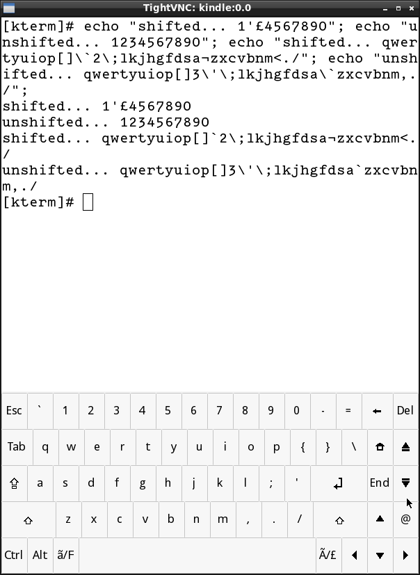

many keys not working, not mapped correctly
Hello I downloaded and installed kterm 0.4 zip from http://www.fabiszewski.net/kindle-terminal/ (I installed only the zip, I think that the patches have to be applied only to source code??)
and installed on a kindle touch, I start kterm by the launcher
I have an apple wired keyboard a1243 with the italian layout. Many keys work (including ň ŕ č ě), but many don't, for example
shift key (no uppercase letters for me)
shift key works with some symbol keys, but when used on "." it types ";" instead of ":"
none of the symbols above the numbers seems correct
I wait for your precious suggestions, thanks

Originally Posted by Gianni View Post
@twobob
Yes, I use the terminal via vnc
Ah. okay...
Let me fire it up via vnc and see what I can think of...
Okay. so easy test:
Type 1234567890 and qwertyuiop[]#';lkjhgfdsa`zxcvbnm,./
With and Without SHIFT down...
Pictured....
As you can see it doesn't work properly on a UK keyboard either.
(This is identical output regardless of the vnc program used - I tried a couple.)
Cheers.
Name:	TightVNC: kindle:0.0_076.png

@twobob Is it possible to use an .Xmodmap on the kindle?

[root@kindle kterm]# what
Kindle Touch!
[root@kindle kterm]# xmodmap --help
usage: xmodmap [-options ...] [filename]
where options include:
-display host:dpy X server to use
-verbose, -quiet turn logging on or off
-n don't execute changes, just show like make
-e expression execute string
-pm print modifier map
-pk print keymap table
-pke print keymap table as expressions
-pp print pointer map
-grammar print out short help on allowable input
- read standard input
you could just use that dynamically in a script. I will try to export it now.
That might work.
Export complete at /mnt/us/export/xmodmap ensure you run xmodmap like:
cd /mnt/us/<whereverYouPutIt>/xmodmap/bin; ./xmodmap
should work. ignore the export logs.

thanks, I copied the file in the kindle and run the command you gave me but the output is still the same...

@twobob
to use kterm via vncviewer, you have to load this modmap on the kindle; the first letter, in order for the shift to work, has to be capitalized, why, I don't know
./xmodmap modmap
keycode 8 =
@twobob
this is getting crazier and crazier
I run on the pc
pi@raspberrypi ~ $ xmodmap -pke | egrep 29
keycode 29 = y Y
now on the kindle I run
./xmodmap -e "keycode = 29 a A"
and magically, on kterm used via vncviewer, the letter y works correctly, printing y and Y (with shift)
WTF???
Okay... I see you did read the manual. my bad
on mine (kindle) if I just run... xmodmap
xmodmap: up to 3 keys per modifier, (keycodes in parentheses):
shift Shift_L (0x32), Shift_R (0x3e)
lock Caps_Lock (0x42)
control Control_L (0x25), Control_R (0x69)
mod1 Alt_L (0x40), Alt_R (0x6c), Meta_L (0xcd)
mod2 Num_Lock (0x4d)
mod3
mod4 Super_L (0xce), Hyper_L (0xcf)
mod5 ISO_Level3_Shift (0x5c), Mode_switch (0xcb)
so. assuming that you are creating a temporarily "fixed" or "corrected" mapping. what would happen if you then rebooted.... It would be wrong again? yes?
It's AGES since I did this.... but... try just running xmodmap after a reboot, check the default mappings. Then run your command above and check they have been added.. then script the changes you need to be permanent.
I am NO expert in this area. I think I used this to remap the middle click on a touch to the left click for getting up blackbox menus.
HTH.
