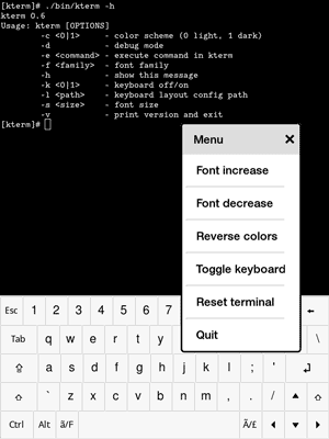

My port of XTerm stopped working with 5.3 firmware. Instead of trying to revive it I took another way. I wrote a very simple GTK+ terminal emulator based on VteTerminal library.
It is available for testing here.
I run it successfully on KT 5.3.2 firmware. It is reported to run fine on Paperwhite. I believe it should also be compatible with 5.1 firmware.
UPDATE: It is reported to run on following devices: KT, KT2, KT3, PW1, PW2, PW3.
Any feedback welcome

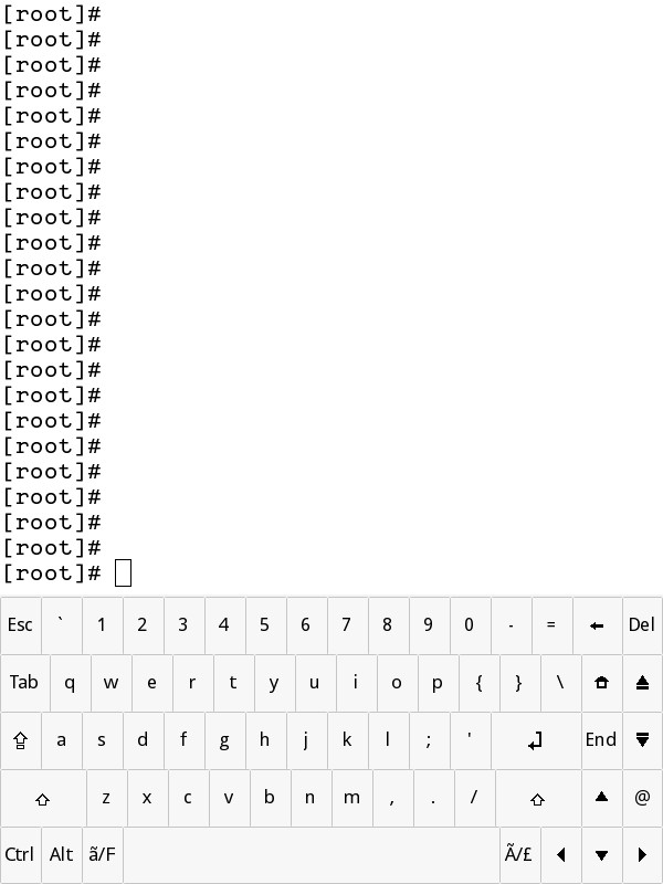

But here seems to be another problem: if I want to run kterm the second time, it will sometimes print a lot of newlines, as is shown in the attached picture. Do you have this problem?
Yes, it happens sometimes. I don't know why yet. Same thing happened in kindle port of XTerm.

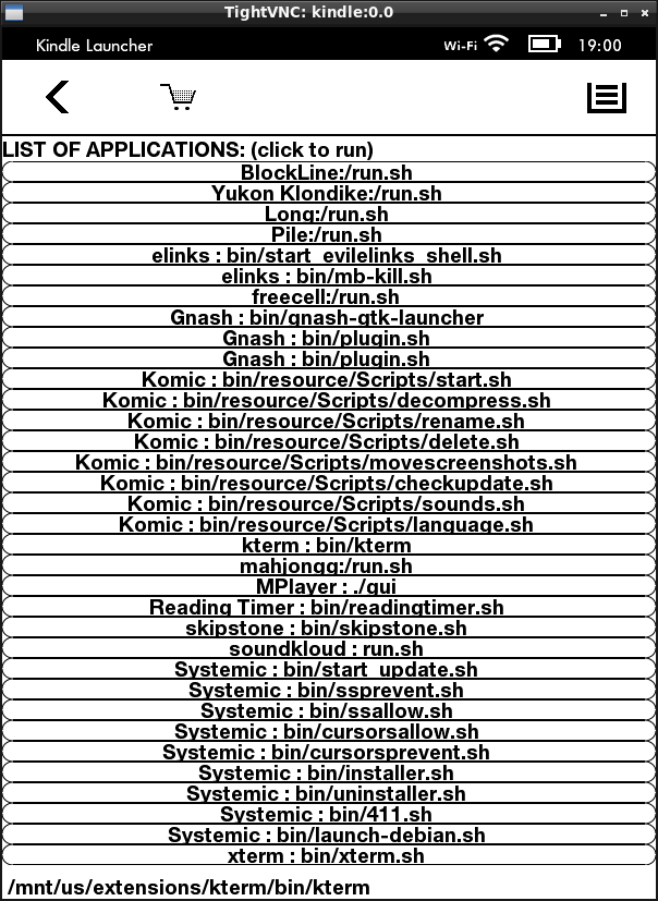

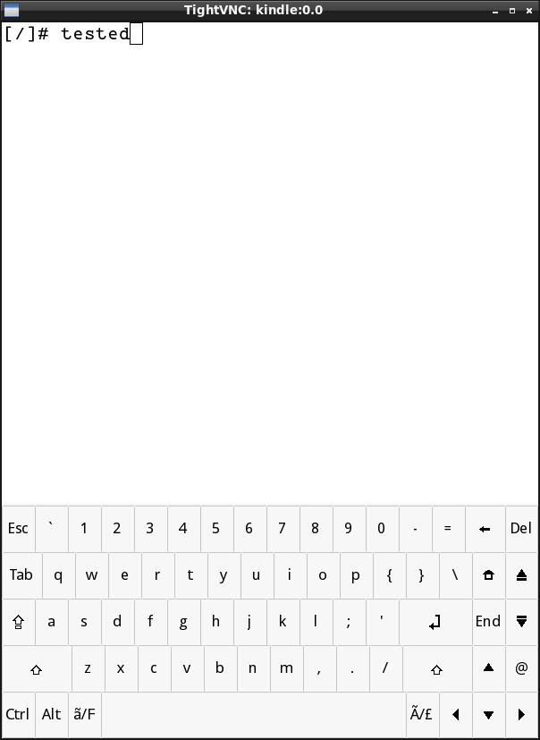

It's wonderfully clean code. Simple and clear make. not a difficult TC to use neither.
In the interim (before a config-able release was to surface it would be a relatively trivial job to slap together yourself a custom version. : )
