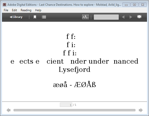

Originally Posted by Man Eating Duck View Post
I had a negative the other day; turns out that ADE 2.0 tries to display ligatures whether the font contains them or not, and Indesign will subset out ligatures whether they are specified in the style or not. Stylistic ligatures like ff, fi,ffi and so on just get stripped out in ADE 2.0, while they display fine on the non-ligature-aware Sony readers.
I don't understand this... do you mean you are entering the "ff" ligatures explictly (using the Unicode code points for them)? That's strongly not recommended, you should write "ff" as two separate letters, and let the renderer/font use the ligature if possible and available.
Originally Posted by ElMiko View Post
And when you say they are "stripped out" does that mean that "æsthetically" will render in ADE 2.0 as "aesthetically" or will it render as "sthetically"?
There shouldn't be any problem with those letters (originally ligatures, but now full-blown letters); æ, œ, ß, &... should be typed explicitly (what I said above referred to stylistic ligatures only).
@ElMiko:As Jellby said, only the typographic ligatures are likely to cause issues.
Here are a couple of screenshots displaying the problem, my workaround is to replace the Indesign-embedded fonts with healthy ones and disable obfuscations, I've actually made a tiny cmd script to do that. The working version with a healthy font is on the right, you can also see that ligatures are rendered correctly in that one.
