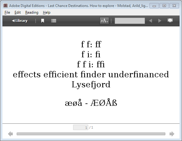

Old 10-19-2012, 07:53 AM   #44
Man Eating Duck
Man Eating Duck juggles neatly with hedgehogs.Man Eating Duck juggles neatly with hedgehogs.Man Eating Duck juggles neatly with hedgehogs.Man Eating Duck juggles neatly with hedgehogs.Man Eating Duck juggles neatly with hedgehogs.Man Eating Duck juggles neatly with hedgehogs.Man Eating Duck juggles neatly with hedgehogs.Man Eating Duck juggles neatly with hedgehogs.Man Eating Duck juggles neatly with hedgehogs.Man Eating Duck juggles neatly with hedgehogs.Man Eating Duck juggles neatly with hedgehogs.
Posts: 254
Karma: 69786
Join Date: May 2006
Location: Oslo, Norway
Device: Kobo Aura, Sony PRS-650
Originally Posted by ElMiko View Post
And when you say they are "stripped out" does that mean that "æsthetically" will render in ADE 2.0 as "aesthetically" or will it render as "sthetically"?
@ElMiko:As Jellby said, only the typographic ligatures are likely to cause issues.
Here are a couple of screenshots displaying the problem, my workaround is to replace the Indesign-embedded fonts with healthy ones and disable obfuscations, I've actually made a tiny cmd script to do that. The working version with a healthy font is on the right, you can also see that ligatures are rendered correctly in that one.
ID:	94451   Click image for larger version
