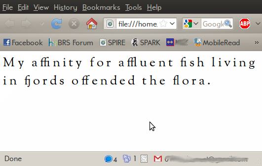

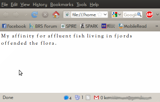

But apparently I was wrong about how smart Firefox is about this, although the results were strange. Testing this document:
<!DOCTYPE HTML PUBLIC "-//W3C//DTD HTML 4.01 Transitional//EN" "http://www.w3.org/TR/html4/loose.dtd">
<html>
<head>
<meta http-equiv="Content-Type" content="text/html; charset=UTF-8">
<style type="text/css">
body
    font-family: 'Sorts Mill Goudy';
    font-size: 200%;
    letter-spacing: 0.2em;
</style>
 <title>LigTest</title>
</head>
<body>
My affinity for affluent fish living in fjords offended the flora.
</body>
</html>
I got different results depending on the font-size. (And not just the font-size selected by the CSS, but it even changed when I used Ctrl-minus and Ctrl-= to zoom in and out.)
Have a look see.
versus
(This is from the same file, just zooming in and out.)
It just occurred to me trying with a <span> around every letter (or ligature), and styling this span with left and right margins... that should work pretty much everywhere, I don't think the <span>s add breakpoints or disturb text searching. This, of course, is only worth doing if there are just a few instances of spaced-out text.
I tested the suggestion of using separate span tags with margin-left and margin-right, and the results were better than I expected. Every viewer I tried was smart enough not to break at the wrong point, and the text was still searchable. Unfortunately, I have hundreds of emphasized passages in the document. It shouldn't be too hard to come up with a RegEx to insert them so I don't have to do them by hand, but it's still going to end up with messy code. I'll have to compare what adds more to my filesize too: inserting all these, or embedding another font per charleski's suggestion.
ID:	49358   Click image for larger version
Embedding another font is probably more robust, and "cleaner", it's like adding another font family/variant next to italic, bold, etc. The downside is it works only if a device supports embedded fonts, and unless you also define (and embed) a font for the main text, you risk the spaced-out font being wildly different from the main one (and the user can't change it).
However, in the case you need it for blackletter fragments, which themselves include normal and emphasized text, I think the embedded font would be the way, and I'd define a spaced-out variant as the "italic" of the blackletter. If the German text uses a different font (even if it's not blackletter), that would be a way too.
