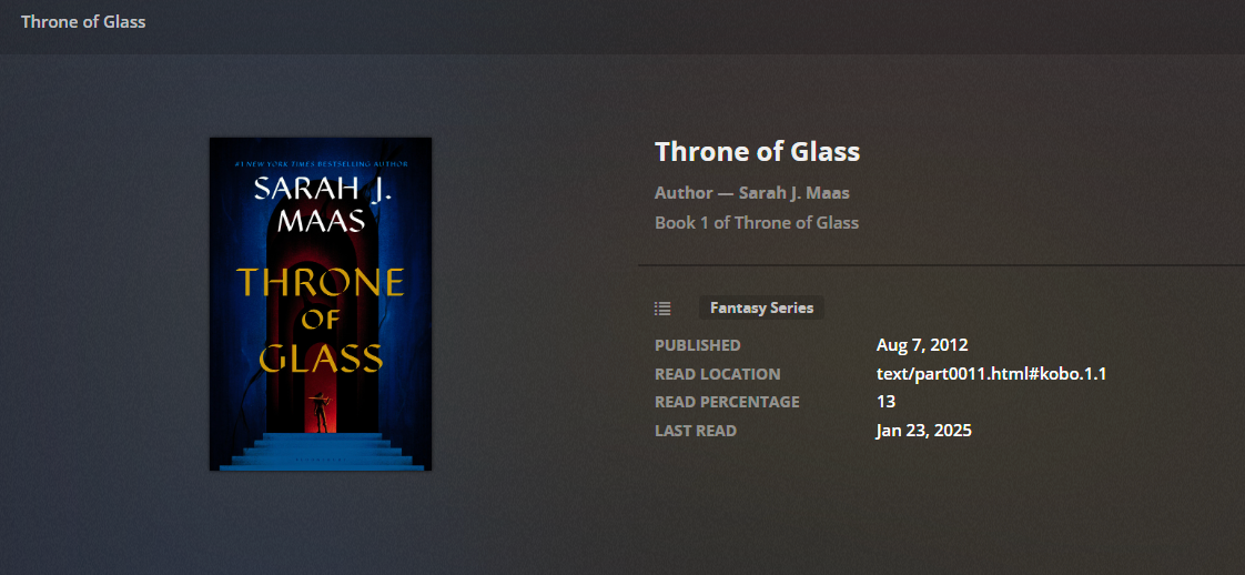

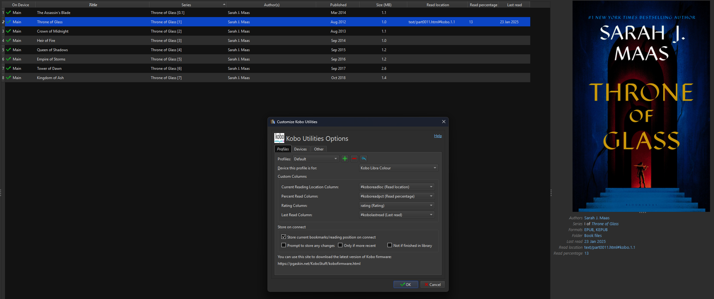

Hi,
I am using Calibre-Web to sync my library to my Kobo Libra Colour. That all seems to be working well. But I am now trying to get read percentage, current location and last read to sync back to my Calibre database when pressing the sync button on my device. I have the columns setup in Calibre as can be seen in the attached screenshots. These columns successfully update when I connect my device directly to my computer. But these values are not being updated when pressing the sync button on my device. Is this something that is possible?
Thanks

Old 01-23-2025, 10:58 AM   #3188
Posts: 46,929
Karma: 169810634
That would have to come from the developer of Calibre-Web.
DNSB is offline
Old 01-23-2025, 11:18 AM   #3189
Posts: 79,983
Karma: 147448039
Originally Posted by matt123d View Post
Hi,
Thanks
You cannot store the reading positions wirelessly. You will have to connect via USB so Kobo Utilities can save your reading positions.
JSWolf is offline

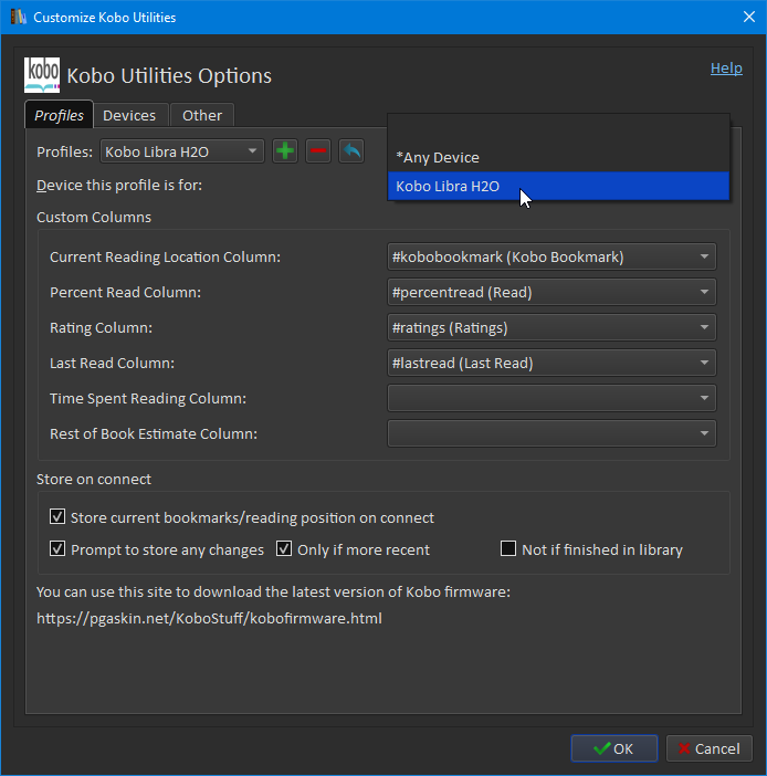

Old 01-28-2025, 10:26 PM   #3193
ownedbycats
Custom User Title
ownedbycats's Avatar
Posts: 11,090
Karma: 76037135
Join Date: Oct 2018
Since you did a factory reset, you may need to re-associate because it forgot your device assocation:
Name:	2025-01-28 23_24_59-Customize Kobo Utilities.png
I can't think of all the words right now but i think this is where you do it.
ownedbycats is offline

I tried your suggestion but nothing changed. I tried adding custom column using #percentread (integer) as I saw you were using this in image you shared. I now have #complete and #precentread. Only books prior to firmware update show in #complete column. Other column is blank.
TomCanute is offline
Old 01-28-2025, 11:05 PM   #3195
ownedbycats
Custom User Title
Posts: 11,090
Karma: 76037135
Join Date: Oct 2018
No, look at the part where my cursor is. Device this profile is for. I think you need to change that.
