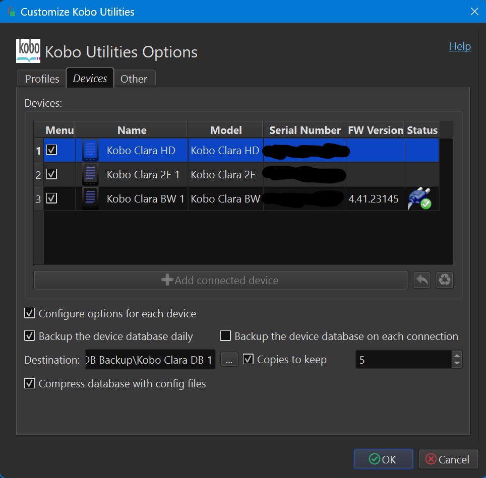

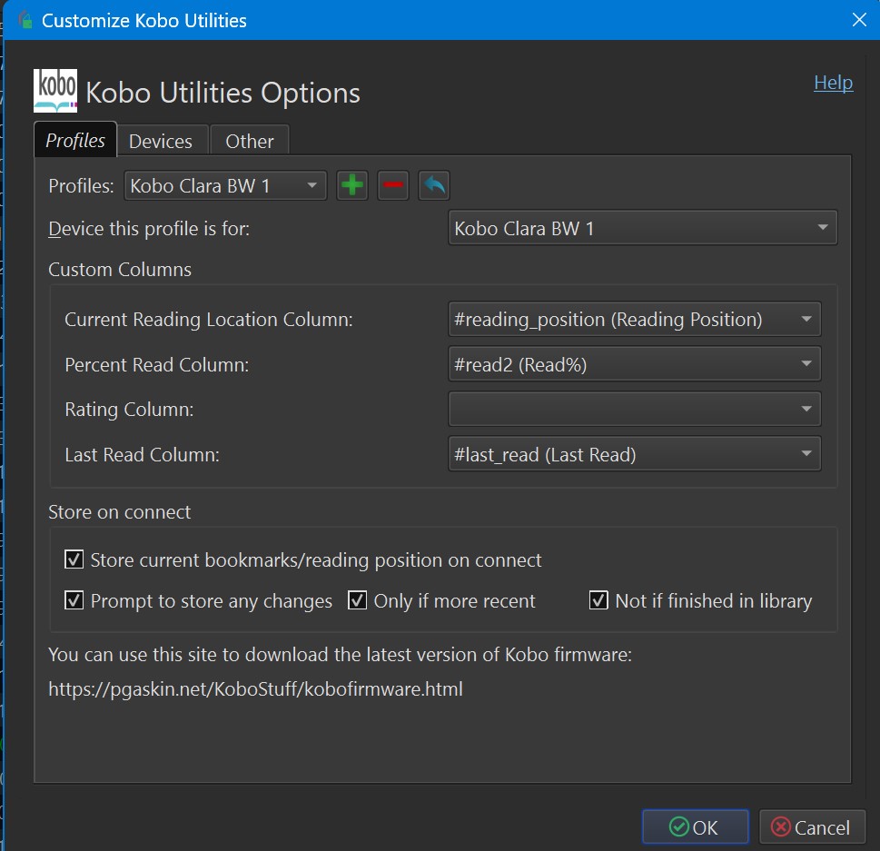

Device: Sony PRS-350; Kobo Clara HD; Kobo Clara 2E; Kobo Clara BW
Have you tried separate profiles for each Kobo? And IIRC I had some trouble getting Kobo Utilites profiles to "stick" sometimes when setting up a new Kobo. It took some repetitious fiddling to get everything on the KU tabs to look right and stay that way.
I currently have three Kobo readers all working as they should (but not a Libra).
The Profiles tab should show the current profile name and matching device. The Devices tab should show the same currently connected device name.
Name:	KU Profiles.jpg
ID:	212273   Click image for larger version
Name:	KU Devices.jpg
Phil_C is offline
I've done it, separated the profile for each of my devices and was able to make it read status but I'm now having a different problem. I did a factory reset on my Libra (without deleting my books). I then pick a random book, set it to 48% reading progress and connected to Calibre (first time connecting the ereader after the reset). It picked up the 48% progress so I click on Cancel and disconnected the device. To make sure that everything is working now, I marked the book (let's call it book1) as Unfinished and opened another book (book2) and move the percentage to 5%. I connected my Libra and when it tried to store the reading data, somehow it still has the 48% reading progress from last time and it did not pick up the 5% progress of book2. I tried marking everything as unfinished again in the device, connected it to Calibre and it still sees the 48% progress from the very first test that I did. Have you ever encountered this issue before?
