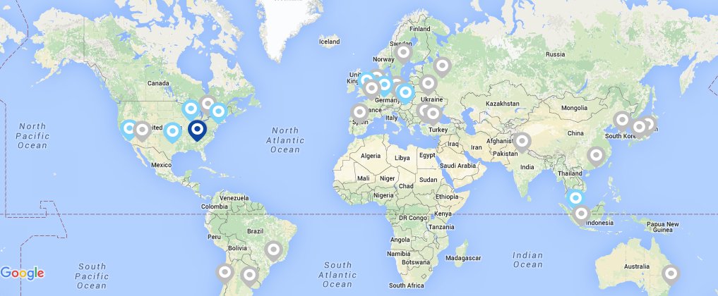

Fun with # 11,000
Please download this test picture:
http://cdn77.gunshi.org/testme/Alice.jpg
Everybody, all around the world, I need some test traffic on the CDN we plan to switch to.
And you can keep the picture, it is public domain.
Based on the content of that picture -
An analogy of a Content Distribution Network (CDN) with a network of rabbit holes.
In the post quoted, Alice went down the rabbit hole.
Presume all of the rabbit holes are 'watched'.
First picture, over a period of time:
Red, Alice was seen for the first time.
Blue, Alice had been there before (file was cached where seen).
Second picture, rabbit hole locations:
Gray, Alice was never seen.
The darker the shade of blue, the more often Alice was seen at that location.
And as an extra bonus -
The link in my signature once again works.
  • Usable as a 'quick check' if the network is serving your area.
  • As an explanation of my signature, for those who skipped 'Music History' (or slept through it).
ID:	150167   Click image for larger version

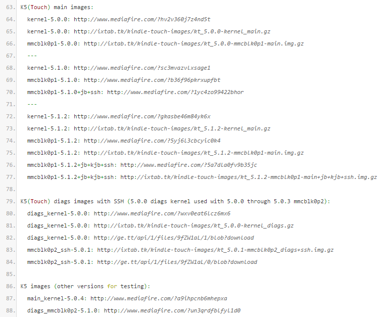

Join Date: Jul 2016
Device: Kindle Touch WiFi (Kindle 5 / K5)
Need guidance with Kindle Touch WiFi (Kindle 5 / K5)
I feel like I am taking crazy pills. I've read the original post multiple times and feel like there is something that I am just not getting.
[TL/DR at end]
Serial Number: B011 1407 1492 XXXX
Firmware Version: Kindle 5.3.7.3 (2715280002)
1. Fully charged - complete
2. Factory reset - complete
3. Access storage via USB - complete (could see /documents, /tts, etc.)
4. Copy over the .bin file - **train derailing noise**
If I understand the process correctly, I am supposed to download my downgrade firmware from http://pastebin.com/Wdw4L7yT. On that page I see not 1 but 19 different (or duplicated?) firmwares to choose from. See attached.
  • kernel-5.0.0: one link
  • kernel-5.0.0: a different link
  • mmcblk0p1-5.0.0: yet another link
I have no clue what mmcblk0p1 is all about. This same set of firmware is duplicated for ver 5.1.0, and is duplicated and expanded for version 5.1.2. A whole separate collection of firmware is listed as 'diag with SSH'.
Considering I am trying to downgrade, I choose the first download, kernel-5.0.0, which leaves me with a .dmg file, not a .bin. I am unable to mount the .dmg nor can I extract it.
TL/DR: I seem to have access to K5 5.0.0 firmware is .DMG format, and evidently need .BIN format.
Hawkins is offline   Reply With Quote
Old 07-12-2016, 07:00 PM   #415
Cinisajoy
Just a Yellow Smiley.
Cinisajoy's Avatar
Posts: 19,161
Karma: 83862859
Join Date: Jul 2015
Location: Texas
[TL/DR at end]
From your serial number, this is not the jailbreak for you. You have the KT1.
Give me one minute.
Try this thread.
https://www.mobileread.com/forums/sho...d.php?t=186645
It is for the K5.
Old 07-12-2016, 07:27 PM   #416
Hawkins
Hawkins began at the beginning.
Join Date: Jul 2016
Unless I am missing something, B011 is a K5: https://wiki.mobileread.com/wiki/Kindle_Serial_Numbers. Also, KT1 doesn't appear at all on that page. Typo on your end perhaps?
Thanks for taking the time to reply.

Old 07-12-2016, 07:46 PM   #418
Cinisajoy
Cinisajoy's Avatar
Posts: 19,161
Karma: 83862859
Join Date: Jul 2015
Location: Texas
You are right on the there is no KT1 listed, it is the K5. But you have the first Kindle Touch. Why I said you have a K T 1. As in Kindle Touch 1.
However the K5 is not the KT2 and this is not the jailbreak you need.
You need the K5 jailbreak which I linked.
Hope this helps.
Oh and we have the same kindle.

Old 07-12-2016, 08:08 PM   #420
knc1
Going Viral
knc1's Avatar
Posts: 17,212
Karma: 18210809
Location: Central Texas
Device: No K1, PW2, KV, KOA
The only thing your missing is the correct instructions for your model:
