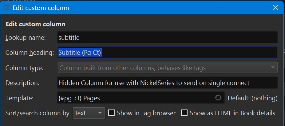

I have the same problem as @RodasQ, I just cannot get NickelSeries to write the subtitle on the first connection.
I suspect my issue is the column type. I'm using type "Column built from other column", it's the only type where I can get the text to appear in the #subtitle column, but I think NickelSeries needs #subtitle to be a text column.
Can anyone please advise how to create / copy a integer column type to a text column type.
Or am I on the wrong track altogether?
Maybe something similar to my solution here:
https://www.mobileread.com/forums/sh...2&postcount=64

Thanks, that's exactly what I'm doing, but it refuses to write the subtitle on the first connection. It appears on the second connection but that's from the Kobotouchextended driver not from NickelSeries.
Note: The Series info is being written on the first connect so that's from NickelSeries.
Can you please confirm the column type you are using?
npr is offline   Reply With Quote

Device: Sony PRS-350; Kobo Clara HD; Kobo Clara 2E; Kobo Clara BW
Name:	Page Count.jpg

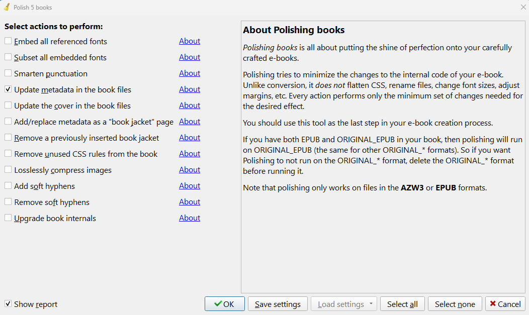

Posts: 120
Karma: 37418
Join Date: Jan 2013
Device: H2OE2, Libra 2
Yes it's working if I force calibre to update the "metadata.opf" file for each book.
Anyone know a bulk way to update that file?
Old 03-15-2024, 06:13 PM   #131
Posts: 48,992
Karma: 174631584
The metadata.opf in each book folder is maintained by calibre and the subtitle should be added there when editing metadata. AFAIR, the only time those files are used is when metadata.db in the root of the library folder is rebuilt.
Again, AFAIR, calibre updates the .opf file internal to the ePub to match calibre's current metadata during the send to device operation. I know you can disable this for a Save to disk operation but I can't remember ever seeing that capability to disable that update for a send to device operation.
You could use the Polish tool to update the metadata in the book files. See attached image for the setting to do only that. The Polish tool icon is the one that looks like a whisk broom.
