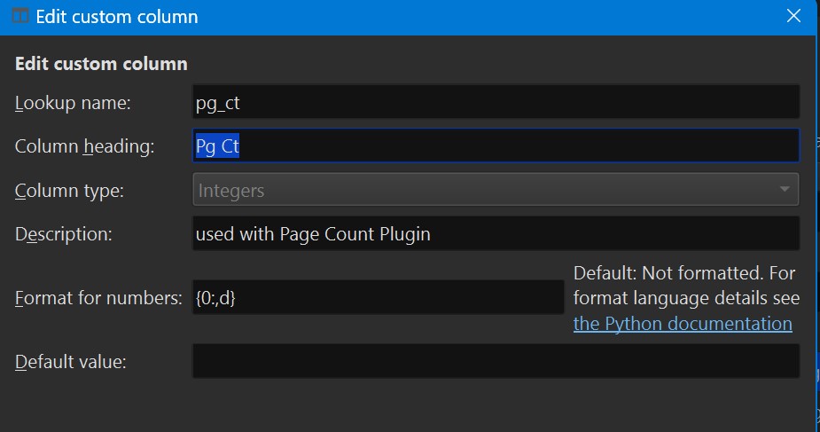

Originally Posted by npr View Post
I have the same problem as @RodasQ, I just cannot get NickelSeries to write the subtitle on the first connection.
I suspect my issue is the column type. I'm using type "Column built from other column", it's the only type where I can get the text to appear in the #subtitle column, but I think NickelSeries needs #subtitle to be a text column.
Can anyone please advise how to create / copy a integer column type to a text column type.
Or am I on the wrong track altogether?
Maybe something similar to my solution here:
https://www.mobileread.com/forums/sh...2&postcount=64

Thanks, that's exactly what I'm doing, but it refuses to write the subtitle on the first connection. It appears on the second connection but that's from the Kobotouchextended driver not from NickelSeries.
Note: The Series info is being written on the first connect so that's from NickelSeries.
Can you please confirm the column type you are using?

Name:	Page Count.jpg
Phil_C is offline   Reply With Quote
