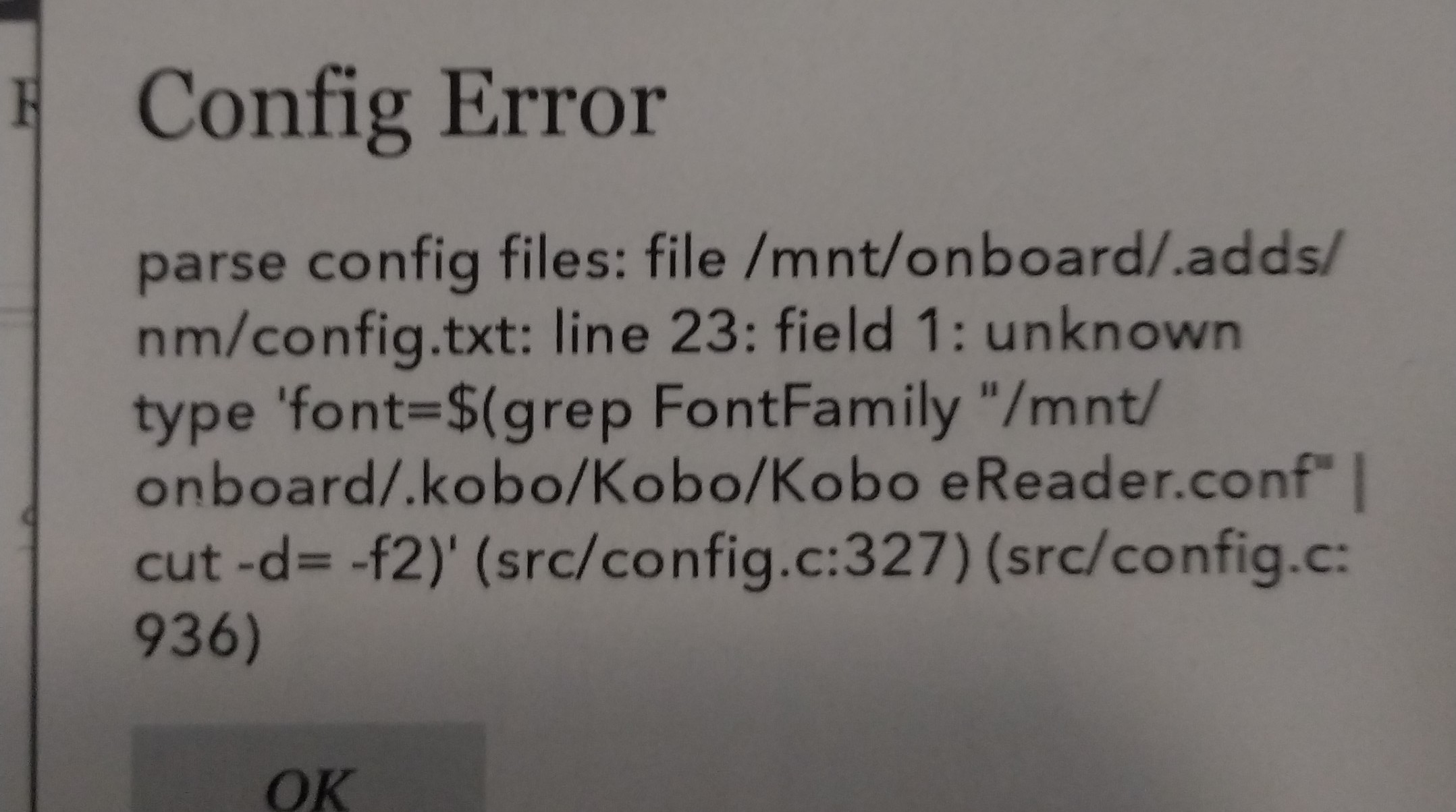

Originally Posted by Aleron Ives View Post
I got tired of the way the font menu has sliders that give no indication of what the actual values are for each font setting
I loved seeing this - thank you so much!!! Unfortunately getting an error which I can't fix. Would really appreciate some help on what I have done wrong.
Name:	Config error.jpg

It looks like you added the script to your NickelMenu configuration file? The script is a separate file that you call with NickelMenu. You only need to add the menu entry to .adds/nm/config.
I did indeed do that and have now fixed it! Thank you very much!!
Trish
