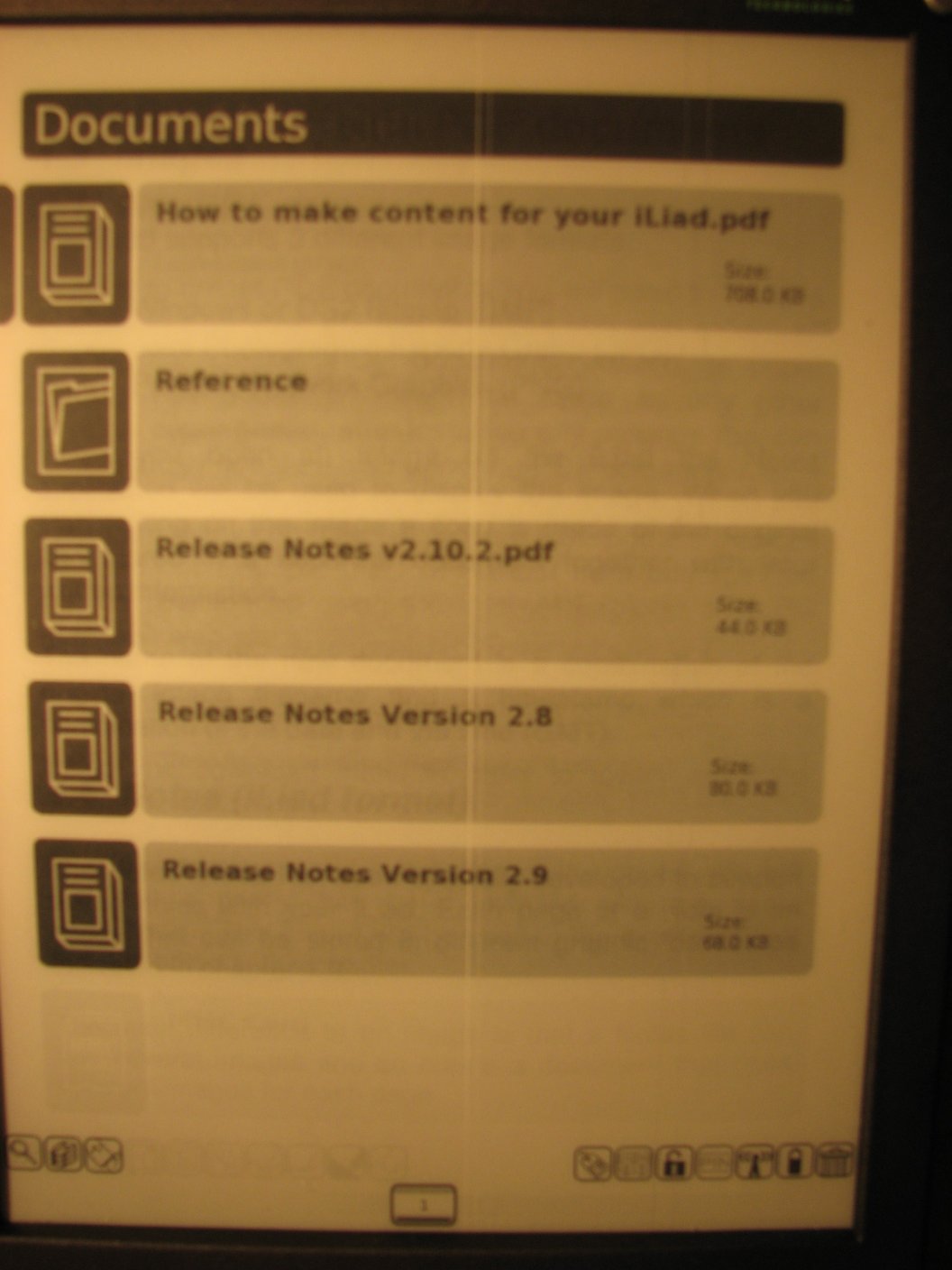

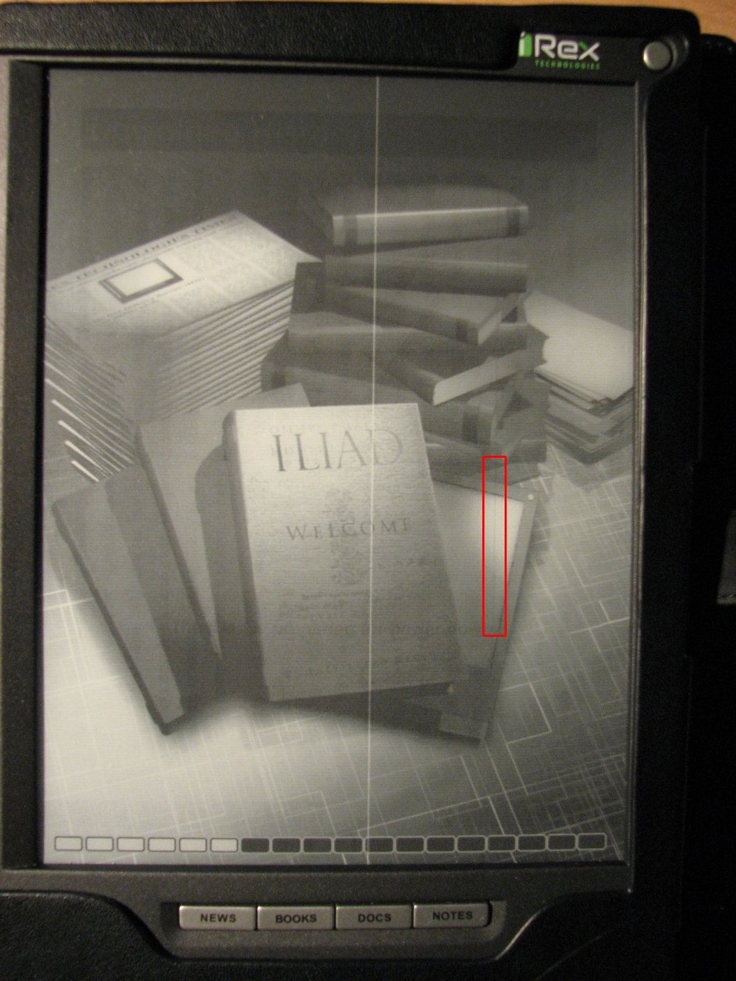

I haven't been using Iliad for some time and today when I have turned it on I found two nasty screen-height vertical lines on the display.
I admit I've been naughty last year frequently betraying my Iliad with my HP Laser Jet, but I didn't expect such a present for a Xmas.
Is it something that I could try to fix myself or the only option is to start hassling Irex support?

I don't think what has happened to my Iliad is happened because of the rough physical treatment.
The display of Iliad is always been protected with the M-Edge cover (https://www.irexshop.com/product_inf...products_id=61) and it looks like the "Power ON/OFF" switch now behaves slightly weird - it takes a little longer for the Iliad to realise what I want it to be switched on or off.
So my guess is the damaged vertical lines on the display somehow been burned out after I had connected it to the PC after a relatively long (1 or 2 months) period of inactivity.
Perhaps it has something todo with the Iliad's battery and the way battery reacts to being recharged after not being in use for a while.
Scifier is offline   Reply With Quote

I'm not an expert, but it looks to me like a "line out" problem where a row of pixels stop responding (similar problem on LCDs). I've seen a case of this in the past on another forum where iRex said that it was covered under warranty. I don't think a broken screen would look like a single white line like that.
I don't know of anything you can do about it yourself unless you know how to fix the hardware under the screen. You'll probably need to contact iRex support.
Shaggy is offline   Reply With Quote

Yup, I had a very similar problem. It was a line-out which manifested as a single horizontal row of dead pixels along the top. Irex repaired it for free and quite graciously after a long back-and-forth where they mixed my device up with another returned device.

I contacted their support a few days ago and so far their actions was quick and professional - the return box for my Iliad is already in Sydney.
Let's see how long it will take them to repair(or replace) the device and get it back to me.

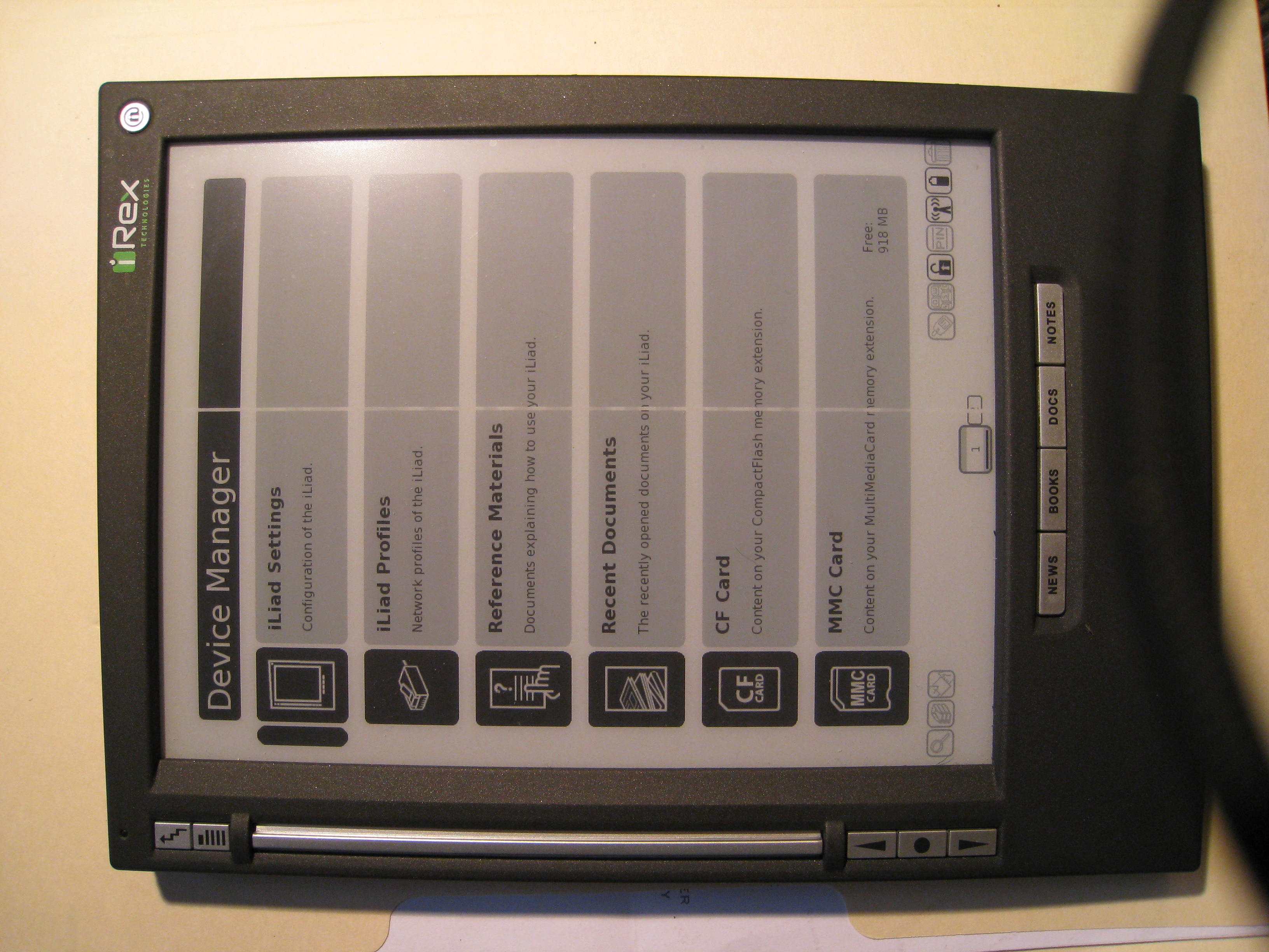

Hi, I was quite surprised to see your pix of your defective iLiad display because my defect is so similar. I have been emailing iRex tech support back and forth, and so far they have not been helpful though I can see from your picture and the other comments that this defect of mine is not particular to my device, but instead a not uncommon defect that the iRex tech people should have immediately recognized. Please anybody else who has info on this unfortunate circustance, weigh in! Thanks.

It looks indeed like a "line error" that falls under warranty. But it could also be something else. I am sure you will be sent a returnbox soon, if youhave sent this image to the iRex support.

Hi, It is obviously important to produce a photograph of a defective iLiad screen to induce iRex support readily to agree to a repair under warranty. My iLiad has a column from top to bottom, mid screen, of non-display (noted in a post heretofore). The photograph of this defect led iRex support to respond immediately with a repair offer. I will keep this thread posted on when I get the box and the logistics of repair. It will be very interesting to see whether in six months to a year from now such screen defects crop up in Kindles. I am wondering if this defect, which a web search shows has occurred in several iLiads (see also iRex forum where users are describing this defect), is inherent to current technical approaches to manufacturing devices using e-ink. As to the speculations in this thread about this defect occurring because a cat sat on a screen or because a device not used for a while was jolted by connection to a computer, I find this self-blame disarming but highly improbable. My iLiad, incidentally, was working perfectly when I set it on a bedside table. The next morning the line appeared when the device was turned on. Absolutely nothing happened to the device during the night. I think it's important for users with similar defects not to try to figure out how they mis-used the device, but to acknowledge that this is a defect and lobby iRex to let us all know what it is and how it is being addressed so as not to occur again in repaired and newly purchased devices.
