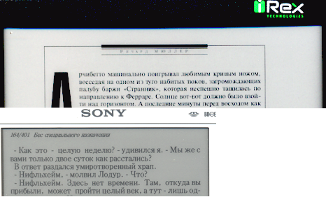

Screen of iLiad one of the best?
I remember some members wrote that eink screen is not enough white.
But I just read several responses of iLiad/Sony Librie/Junke V8 owners and they all told that only iLiad has almost white screen.
See these three photos
http://gosha.pri.ee/iLiad/iLiad_2.jpg
http://gosha.pri.ee/iLiad/iLiad_1.jpg

The two linked photos seem like unedited photos of the iLiad, the attache image on the other hand shows a too white screen. See how the iRex logo overcasts?

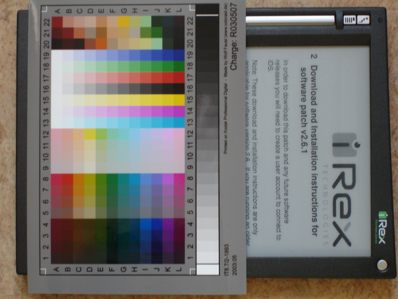

Here's a photo of my iLiad, showing a PDF document, together with a standard IT8.7/2 target. The important thing to check is the greyscale band. The 'whiteness' of the iLiad screen seems to be around 80% (very rough eyeballing and mental calculation).

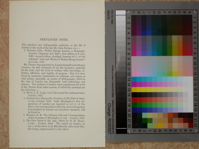

Here's another photo of a book page with the same target. The whiteness of the bookpage is very close to white -- I think above 95%. The book is from the 1890s, and is printed on toned paper, so it is slightly lower in tone that most modern books I buy except paperbacks, which are still lower.
(I see there's some vignetting from the lens setting I used so compare the page at a point near the target point of reference.)

According first one, iLiad's white is 3 from 22 (1..22). It's a very good result. Like usual white book's page.
I'm still waiting for my iLiad and will write about my impression later.
But I see that screen of iLiad has a very good white color, according my needs.
Also other owners of Sony Librie and Junko V8 said that iLiad's screen is much whiter than those screens. And iLiad's screen looks better on various angles of reading than screens of competitors.
So I think that almost in 2 times larger screen and much whiter

I should have explained better: I was not primarily out to get an absolute value of the grey level of the screen of the iLiad, but rather to suggest that very 'white' photos may have been (intentionally or unintentionally) biassed. (I can't decide if the third? photo/thumbnail was taken of both devices at the same time: that white area to the right seems suspicious.)
Difference between two screens can be compared only if both screens are shown in the same photo. Establishing the absolute difference needs a standard target in the same photo. (Even then, it may not give an accurate idea of what the screen looks in *your* light.)
But if you want absolute level ... 3 is far too high. I placed it at around 80% myself, but that was not based on a very careful inspection, as I know I have two level of screen adaptions going (one Adobe gamma adjuster, and one Nvidia adjuster) that can affect my perception of the images.
Some lab work follows. I'm checking histogram of a manually selected part of the original image (i.e. before they were resampled for the web. Resampling was 'intelligent' which probably means that things may have changed). I use the L value (lightness) of the HSL model as an approximation. (There should be no difference in using either greyscale model, or converting the image to greyscale before checking the pixel value -- and indeed repeated testing this way produce the same values. )
A) Iliad + target picture:
White box has L median 227, black box 31. A selection of the white area below the first paragraph gives 161. Box 7 median is 158, box 6 median 169, so it's between levels 7 and 6. The HSL lightness of the best part of my screen in this photo is approx. 71% (i.e. 161/227).
B) Book + target picture:
White box: 193, black box 3 (so either daylight changed, or my camera rebalanced the image: probably a little of both). A selection from the central part of the right margin of the page has a L median of 188, which ends up as HSL lightness 97%.
Based on this, the iLiad screen should not be described as paper white -- at least not the paper I used as comparison. It ends up at a little better than 2/3.
(In each case, the histograms of the selected image area are symmetrical and fairly 'tight', so median should be about the same as average. It's first when I select the entire book or visible iLiad page that the histogram gets clearly lopsided towards lower values, and so would give a obviously lower average than median.)
However, for reading ease, I don't think paper whiteness means as much as contrast between foreground (text) and background (page). I have no idea of how to measure that, though, as colour has to be taken into account (black text on light yellow paper reads better than black on pure white, for instance).
