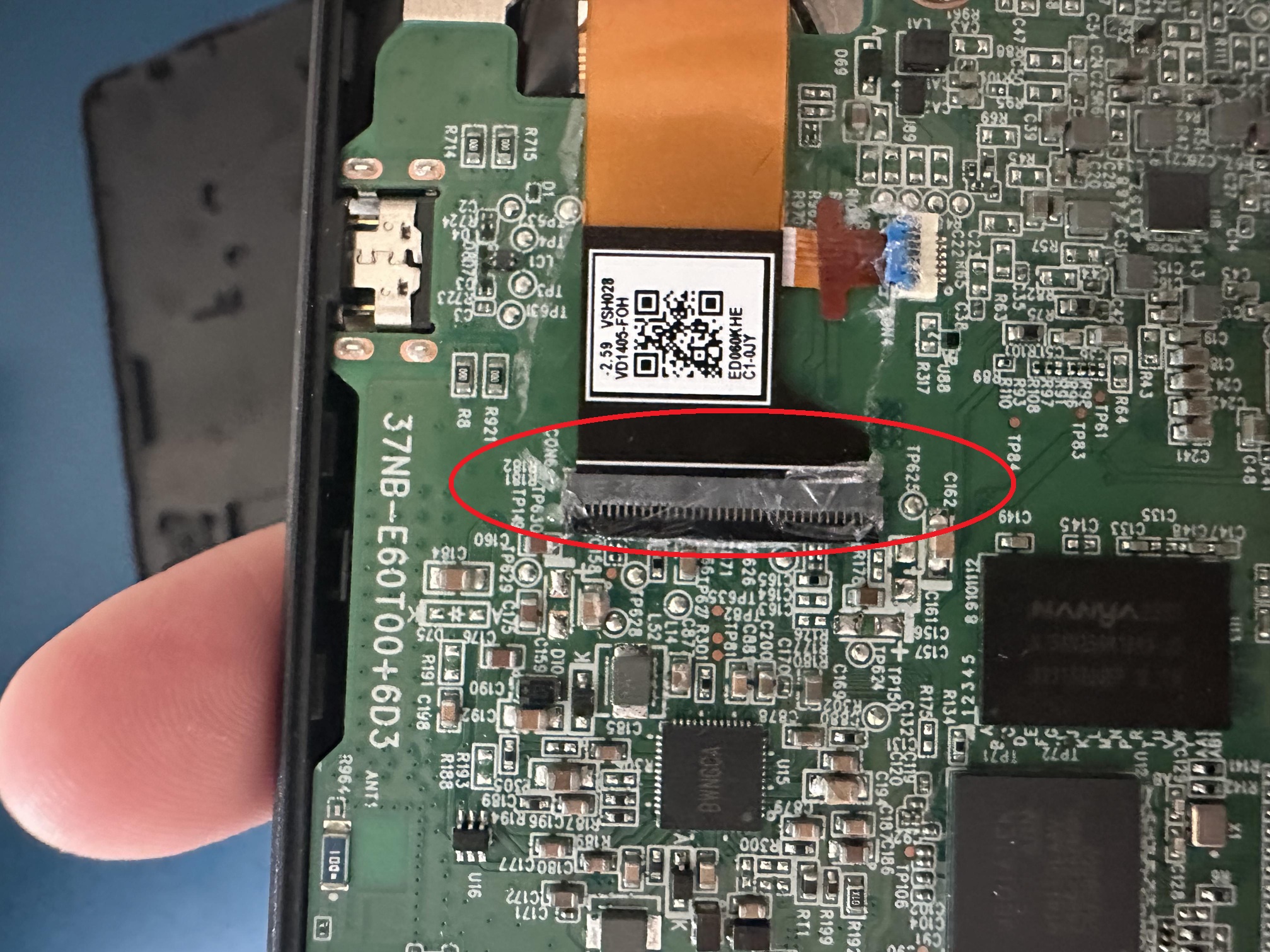

Hi all,
I just replaced the screen on my Kobo Clara BW and have been getting a weird issue. When the screen refreshes it looks fine, but after about thirty seconds the screen goes all grainy (see pictures). I've updated the VCOM to match the new screen and as far as I can tell the motherboard is connected to the screen correctly. I didn't see any damage on the leads as I was reassembling the kobo, though I'm not sure if that dent in the battery has something to do with it. Any ideas on what might be going on?

What vcom value did you enter in the vcom file before copying it to the root of your Kobo's exposed storage? I am doubtful that the vcom number would have that effect on your Clara BW's display since once the black and white particle are moved into place, they should be pretty much static but have not played with the effect of changes so it's possible.

I entered -2590 (1000x-2.59 as shown on the third photo above). When I first booted it after the screen replacement I hadn't changed the VCOM yet, but even after fixing the VCOM the issue persists.

What does the vcom value in Settings => Device Information => Firmware Information show? Again, I suspect this is not a vcom issue since it occurs on a static screen. What happens if you do a sleep or shutdown with the cover showing?

With such a picture, the vcom value has nothing to do with it. Look here, is it cleaned well there:

I thought I had pulled all the plastic out of the connector slot, should I just go in and remove all the plastic in the vicinity?
I would disconnect it, then be sure everything is clean, then reconnect.

The connector seemed clean, the only damage to any connector I could see was maybe a small scratch on the backlight connector, but I haven't had any backlight issues. As best I can tell, I damaged the battery when removing it and there's some issue with power discharge happening at the wrong time. The fading to graininess only happens when the ereader is on, not when sleeping or off. That's a total guess though, open to any other solutions you might have.
I can send you KoboRoot.tgz with these values:
520_VSH019_HS3401_ED060KHEC1_VD1405-FOH_TC
But first save your original wf_lut.gz file and send it to me so I can try it myself first. Or so you can get your file back. You can save it using the KOReader file manager. The file is located at data/init_bin/wf_lut.gz.
Or you can get the image like this: https://www.mobileread.com/forums/sh...&postcount=576
Only for clara BW/Colour/Libra Colour I use this command:
head -c $((512 * $(cat /sys/block/mmcblk0/mmcblk0p11/start) )) /dev/mmcblk0 > /mnt/onboard/mmcblk0.rawimg
wf_lut.gz is in waveform.img.
https://ibb.co/ZzNMbD6y
Waldy is offline   Reply With Quote

Sounds good. I'm fixing this up for my girlfriend so it's at her place and I don't have access to the files right now, but I'll get them as soon as possible. I tried replacing the battery and the issue is still persisting.
For my own curiosity, what do those files control / what's your diagnosis of the problem?

So I guess we'll rewrite the Waveform value to see if it changes anything for the better or worse. I can provide files with other values ​​later, but first you'll need to save yours to go back to how it was.
