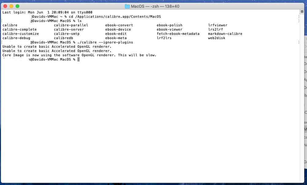

Not at a Mac at the moment but I think the following should work:

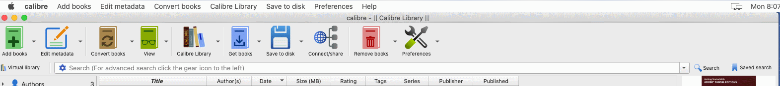

cd /Applications/calibre.app/Contents/MacOS
./calibre --ignore-plugins
Edit: Checked on my virtual Mac and the above seems to work. See attached images.
