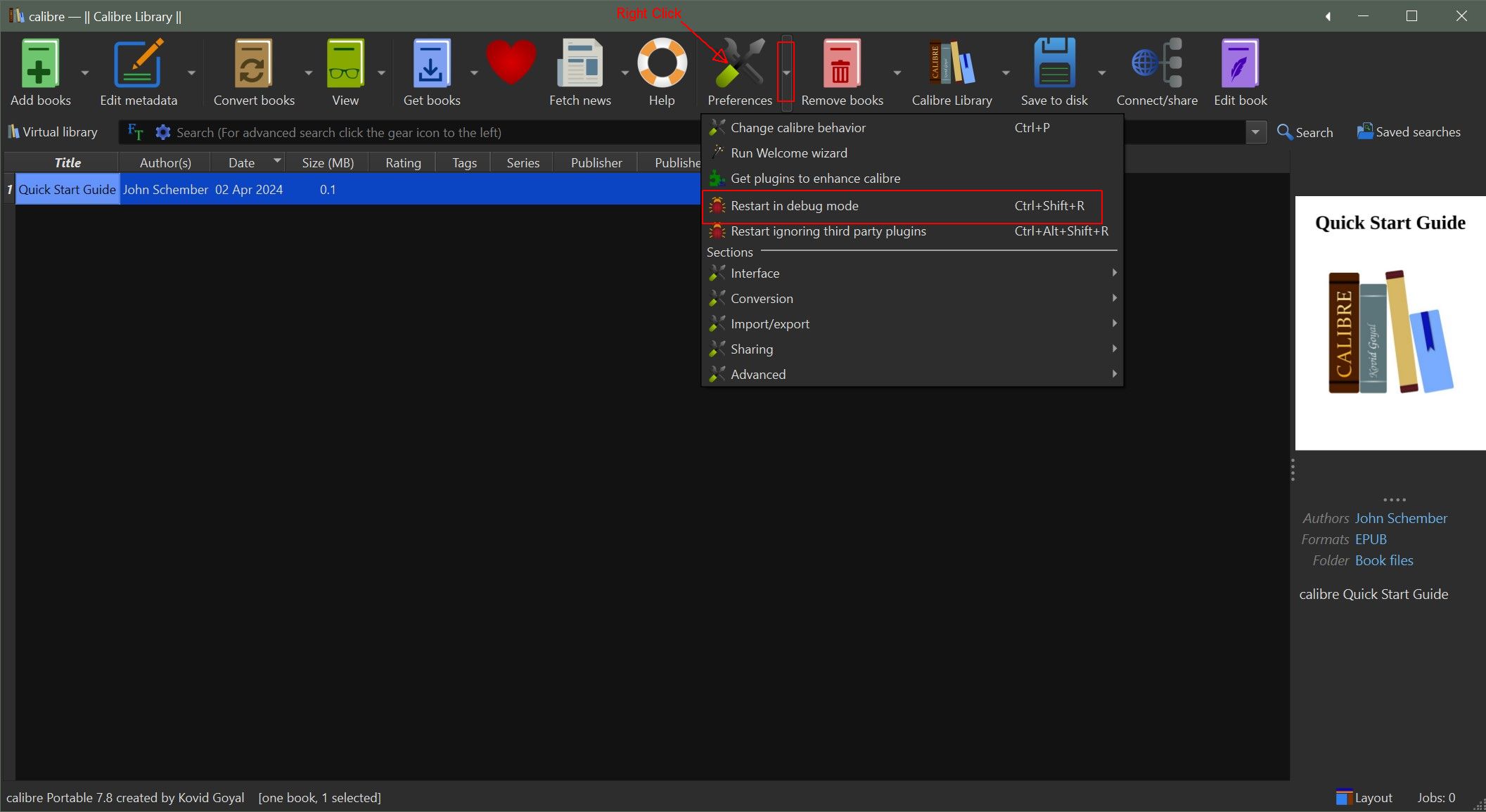

I can't find this option in the preference menu!
HKuser is offline   Reply With Quote
Old 04-10-2024, 05:02 AM   #7
Posts: 22,898
Karma: 34252744
It's in the Preference button menu, not the icon grid
Name:	Screenshot 2024-04-10 175559.jpg
Ctrl+Shift+R is easiest.
