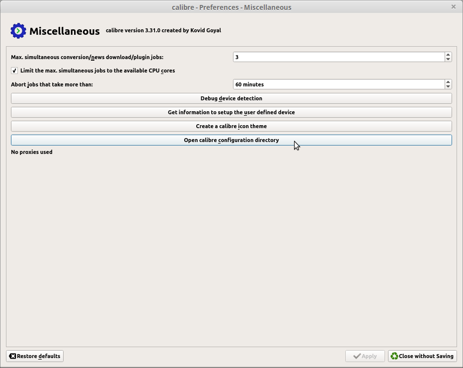

A temporary workaround for this problem.
Go to
Preferences-Miscellaneous--Open calibre configuration directory
Then delete the file metadata-sources-cache.json
This is will only work as long as you do not close calibre, you close then you wiil have to replete.
Go to
bernie

Old 09-10-2018, 04:26 PM   #12
nwgal
nwgal began at the beginning.
Posts: 11
Join Date: Sep 2018
Location: Pacific Northwest
Device: Nook
Okay, never mind. I tried it again, and it worked. THANK YOU. So is this a permanent fix? Will we have to do this each time we open Calibre?
Go to
bernie
It worked! But only ONE metadata download works, then the poison cache-file is created and the process fails as usual. This focuses the source of the problem, which is good, but it's a cumbersome workaround.
PacificNW is offline
Old 09-10-2018, 05:41 PM   #14
PacificNW
Junior Mint
PacificNW began at the beginning.
Posts: 5
Join Date: Sep 2018
Device: Kindle of DOOM
Some Progress, but a bit strange
Instead of deleting the file "metadata-sources-cache.json" I set it to be a zero-byte-sized file.
Now it all works again.... even repeatedly through calibre restarts, etc.
BUT... a strange BUT.....
When I download metadata for popular titles, now they are almost always for the audiobook versions of the books [I don't use audiobooks].
Have NEVER, over years of use, seen this happen.
So the fix is still partial, but liveable for now.
EDIT: I also tried a two-byte file, containing an empty JSON dataset {}. This also works.
Last edited by PacificNW; 09-10-2018 at 05:51 PM. Reason: Added info on empty-JSON file instead of zero-byte file.
