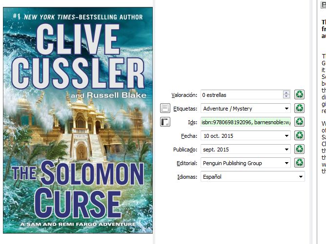

This is what I got using goodreads metadata dowload (same other sources: Amzon.com, B&N, FantasticFiction):
And no 984 at the isbn.

All of them (turned off all but one, and all of them have the problem). The first time I look at Amazon.com I get two matches, one without summary and Spanish language and one with summary and English language but other ISBN.

I dont understand what you are saying. If you put in an ISBN that points to a spanish language edition, then you will get spanish as your language. Remove the isbn and use only title and author. As I posted before, using only title and author with no isbn returns the correct, english language result from both google and amazon for me.
I'm pointing to an edition that, because of some reason, doesn't have language as a property. When this happen, instead of leaving the language field alone, it's filling it with the interface language (I've switched the interface from Español (Spanish) to English, and the field is fulfilled with English (if I change to Català, the field is fulfilled ith Català). I suppose it has always happened the same but I'm finding now more editions without this field fulfilled.
Perhaps it's the normal way to work or there is a tweak, I don't know.

For example when I look at the log for The solomon curse, I see two results from amazon, one of which does not have a language, and visiting that result's amazon page, shows that indeed, the language is not specified there:
http://www.amazon.com/Solomon-Curse-...rds=B010EW0LFC
