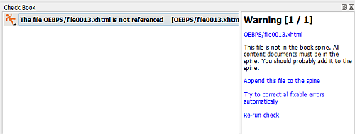

Ok, it just happened again, and the OPF was open.
I also noticed that when I opened the file, and started hitting the page down button, the preview didn't keep up as it usually does. Then I saw the file was gone from its place. I still cannot say that I touched any other key except the page down button, I'm as sure as I can that I didn't -- or at least now enough that I would even feel it.
Attached are 2 screenshots (ok, not exactly a 'splotch' for an icon, but...)

@MerlinMama - FWIW: in the interests of tidiness, I close all codeview windows (repeat Ctrl+W until they're all gone) before and after using tools such as Spellchecker and Reports.
I can't induce your problem, as you rightly point out its not drag drop.
The icon (dialog_warning.png) is a man falling backwards. So, I am wondering if you unchecked Show this warning again on a message at some time, but I can't see where to reset them back to checked, in Editor Preferences.
I've decided to never uncheck the Show . . . again options in calibre. I did initially - out of habit. But unlike some software, calibre doesn't issue warnings without good cause. In some cases, e.g. delete book are you sure, I question whether the option to never show the warning again should even exist.

I will certainly try and remember that, although it does only happen rarely. If it is related, that does explain why I can have months between occurrences. Although it would have to be close them AFTER because double-clicking the words to check context if necessary is what opens the files...
I am wondering if you unchecked Show this warning again on a message at some time, but I can't see where to reset them all back to checked in Editor Preferences.
I don't have any disabled confirmation prompts. You can reset them under Preferences. At the bottom of the window, you have three buttons:

I found a way to get the result you show in your screen shot. Open the epub with the calibre library Unpack Tool, drag an html file out of the root to into the META-INF folder and rebuild the ePub.
I imagine one could do similar in the temporary folder the editor uses.
Hardly the sort of thing one would do inadvertently - but it might provide a hint to someone.
