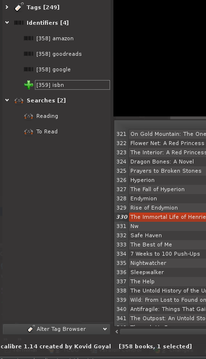

Library count not matching the number of books
I have 358 books in the library. The number next to the "isbn" identifier is 359. When I click on it, on the bottom of the screen shows '358 books'. All other book numbers and totals add up.
How do I find "ghost" book?

I attached screenshot that should make it clear.

Ah! Yeah, the problem is clearer.
Now seeing this... I thought at first that there was maybe a book with two ISBNs, but I've tried that and the second is automatically removed (Well actually the second in the identifiers list had priority and the first is removed).
Strange...
EDIT: Try to install the Quality Check addon; the "Check metadata/CheckISBN" option can maybe track the error.

His (her?) screenshot tends to show that there are only 358 book in the collection/library/virtual library. Since the tag browser lists 359 ISBNs, either a book has two ISBNs, or the identifiers table has an orphan record (a record whose 'book' field has an ID not in the `books`table).
If the former, your search query (I didn't know that one, thanks) should show which book.
If the latter, a query like 'SELECT * FROM identifiers WHERE book NOT IN (SELECT id FROM books)' should list the record in error.

Thank you very much for all the help. I followed instructions and found orphaned entry in identifiers table. I deleted it and it is all good now.
