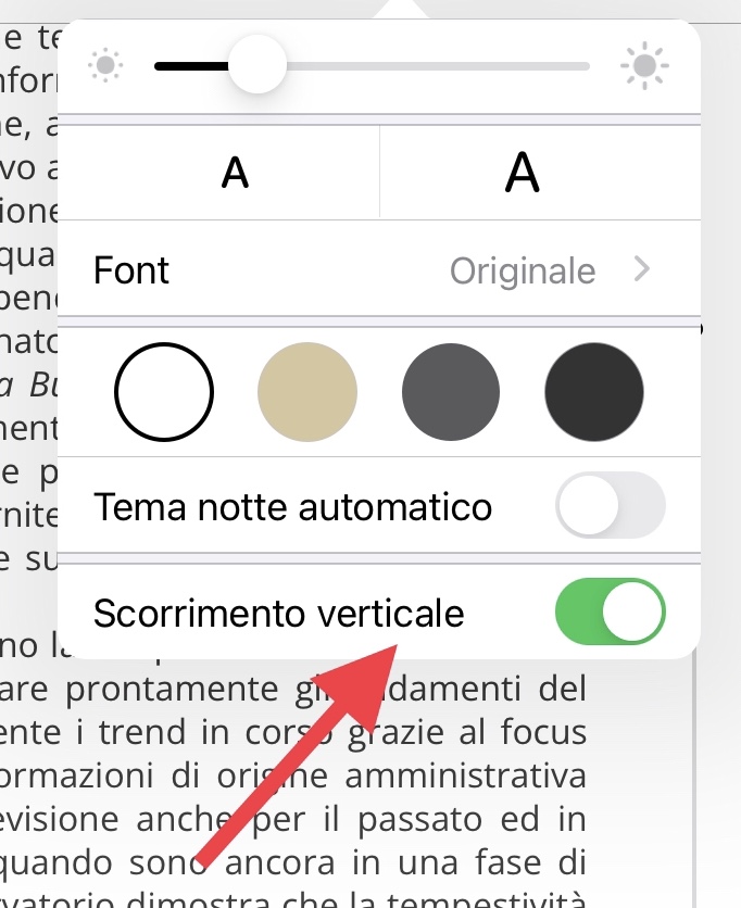

Hi guys!
I am creating an ebook (reflowable epub3) that contains many tables of different sizes.
The best readability of the book is achieved in 'vertical scrolling' mode. But I ask you: is it a common feature for all ereaders to be able to set reading in vertical scrolling mode?
I have tried it with iPad. What experience/reader do you have?

iPads "Books" app does it, so does Marvin (on iOS), so do desktop readers/viewers such as Sigil and Calibre. I'm not very familiar with the other devices/apps but I would not design a commercial book expecting their device/app to do that.
There have been a couple discussions here about tables and proper best-practice formatting (Tex will pop in here in a little bit with the links ). Generally speaking, 2 - 3 columns max is acceptable for text that really needs to be in a table; try and display the text in an alternate (reflowable friendly) format if possible. If the table must be larger than that, then it's better to embed an image of the table. BEWARE: Audio listeners will lose the information presented if you do this.

No. The main reading method of ebooks is "pagination", similar to a physical book.
It is not like a website, where you have infinite scrolling down.
Like Turtle/Quoth have said, some ebook readers have an option to enable "vertical scrolling", but that's in the extreme minority.
(And all physical readers—like Kindles, Kobos, etc.—do not have vertical scroll.)
