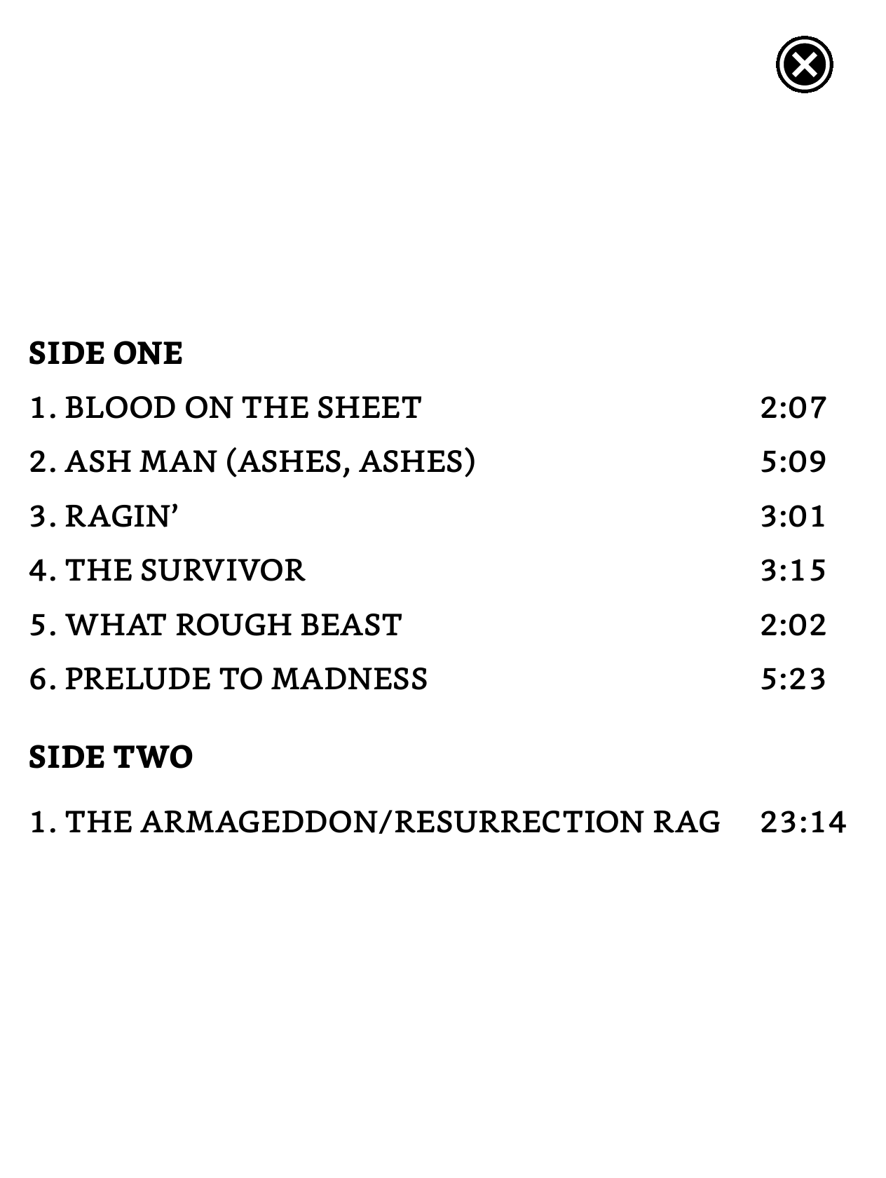

The table viewer is part of the KFX renderer. It is enabled during conversion to KFX only for tables that meet the criteria to be considered a "data table". (I haven't investigated exactly what those criteria are.)
When enabled the table is followed by an icon of a box with a diagonal two headed arrow indicating that the table can be expanded. Clicking that opens a screen containing just the table that can be panned and zoomed like an image to view it in more detail.
