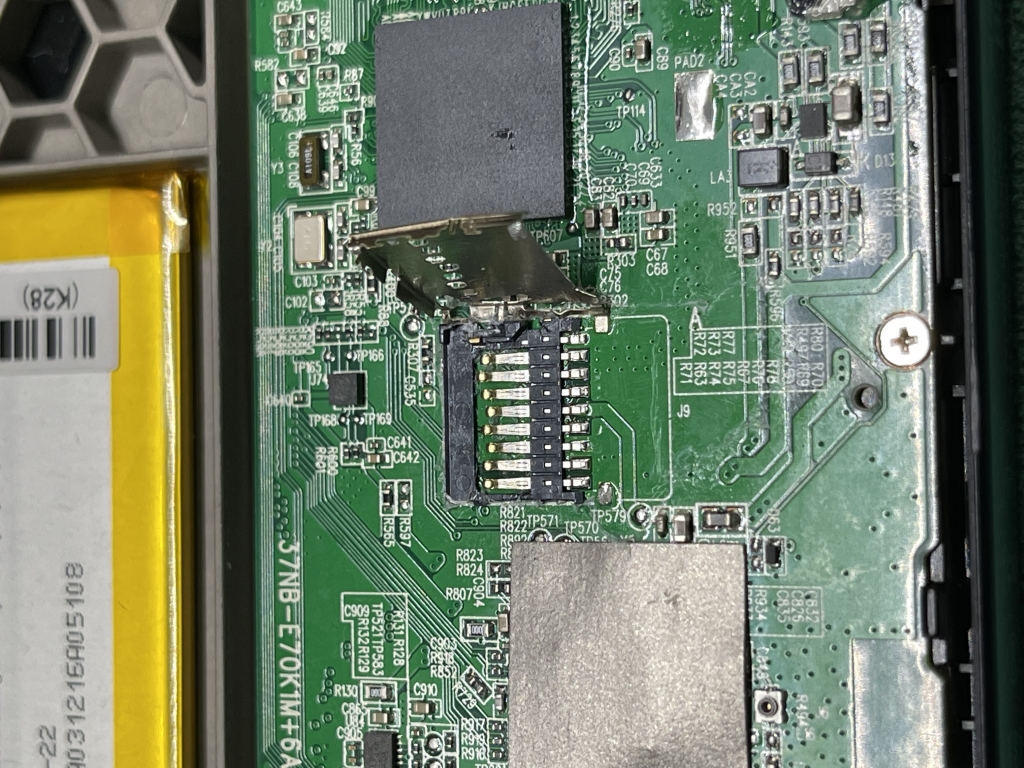

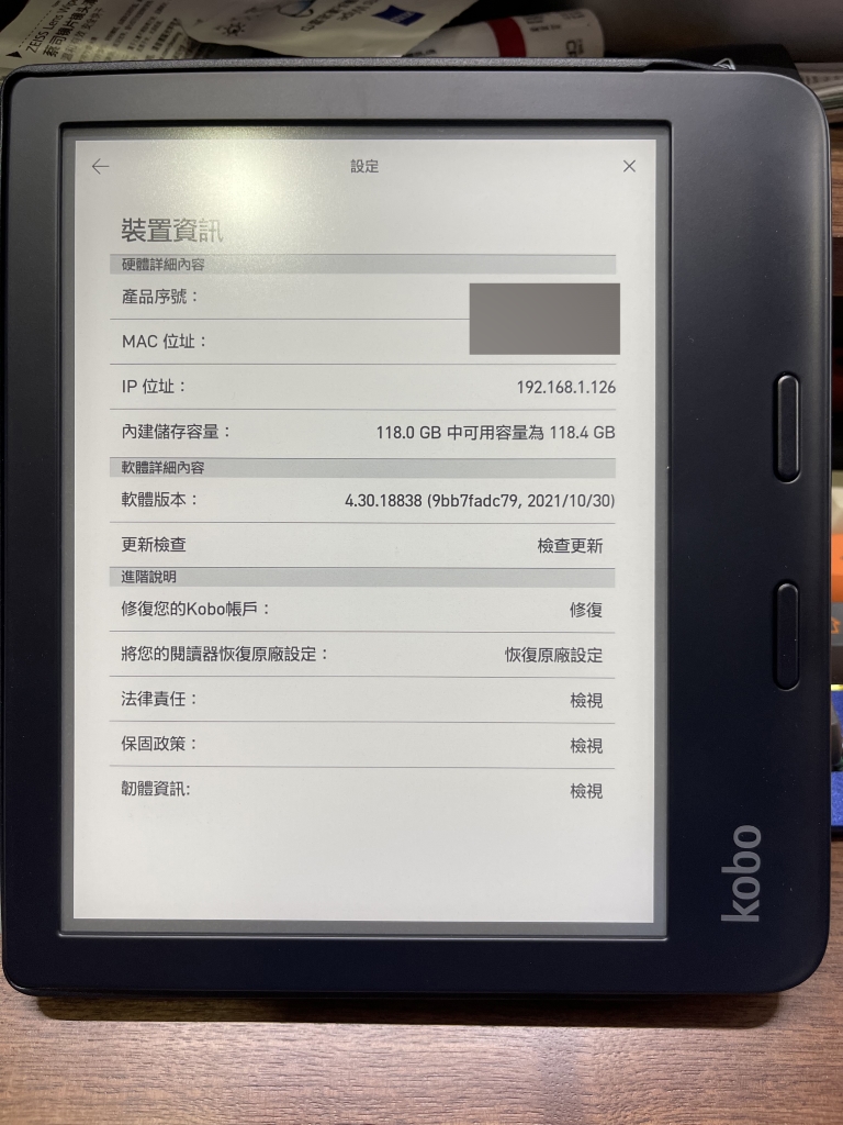

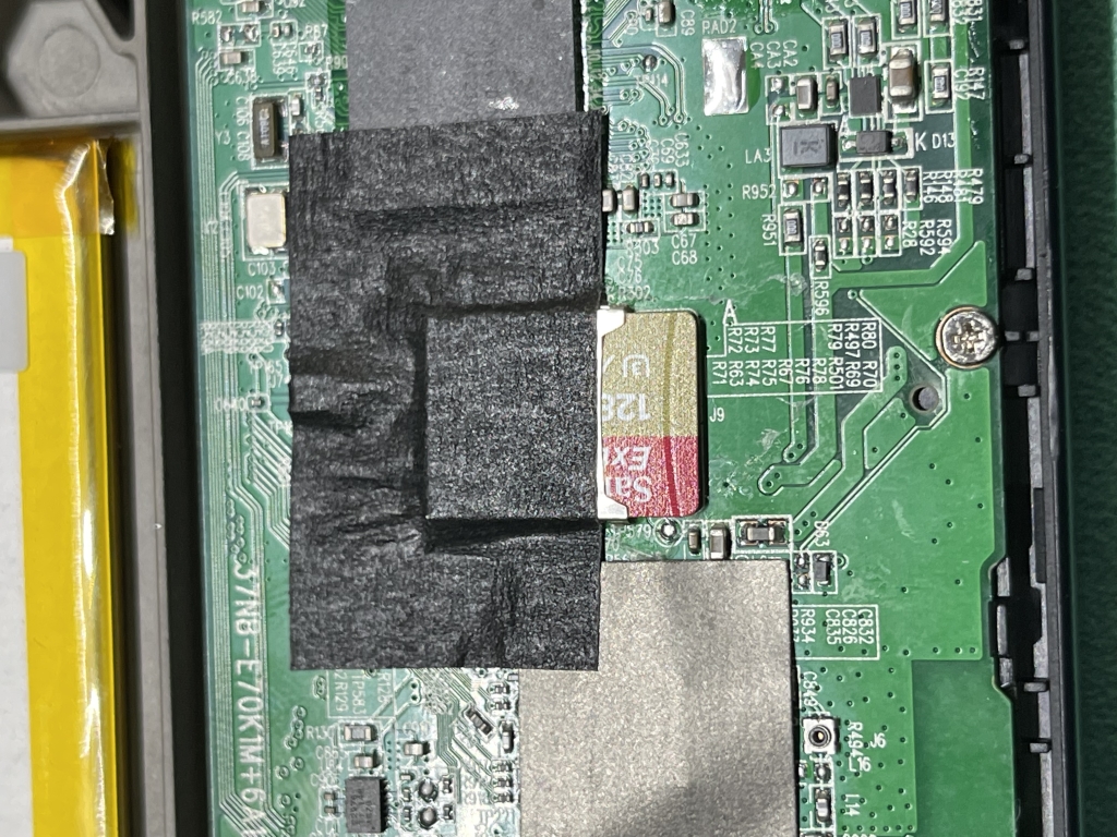

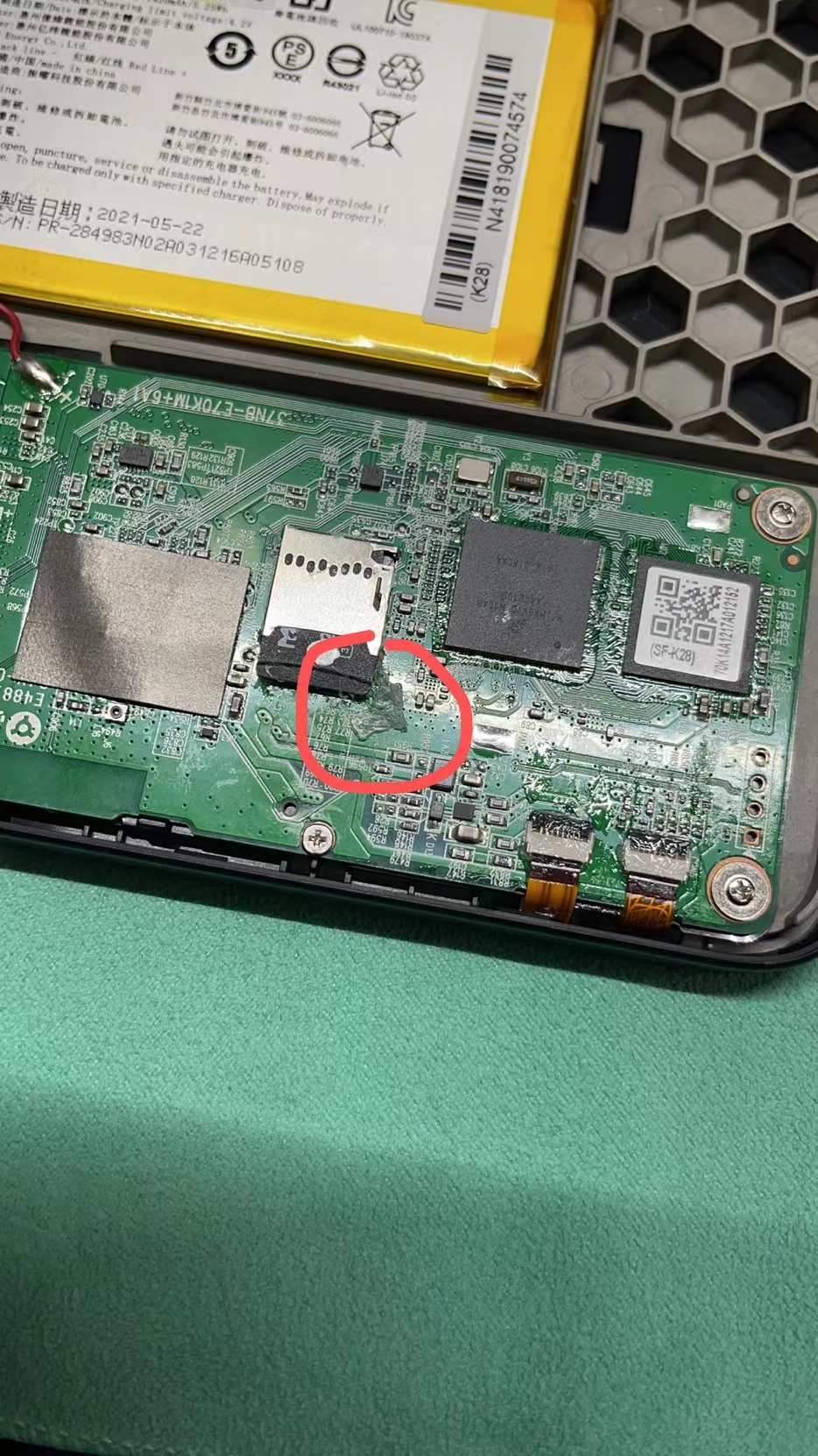

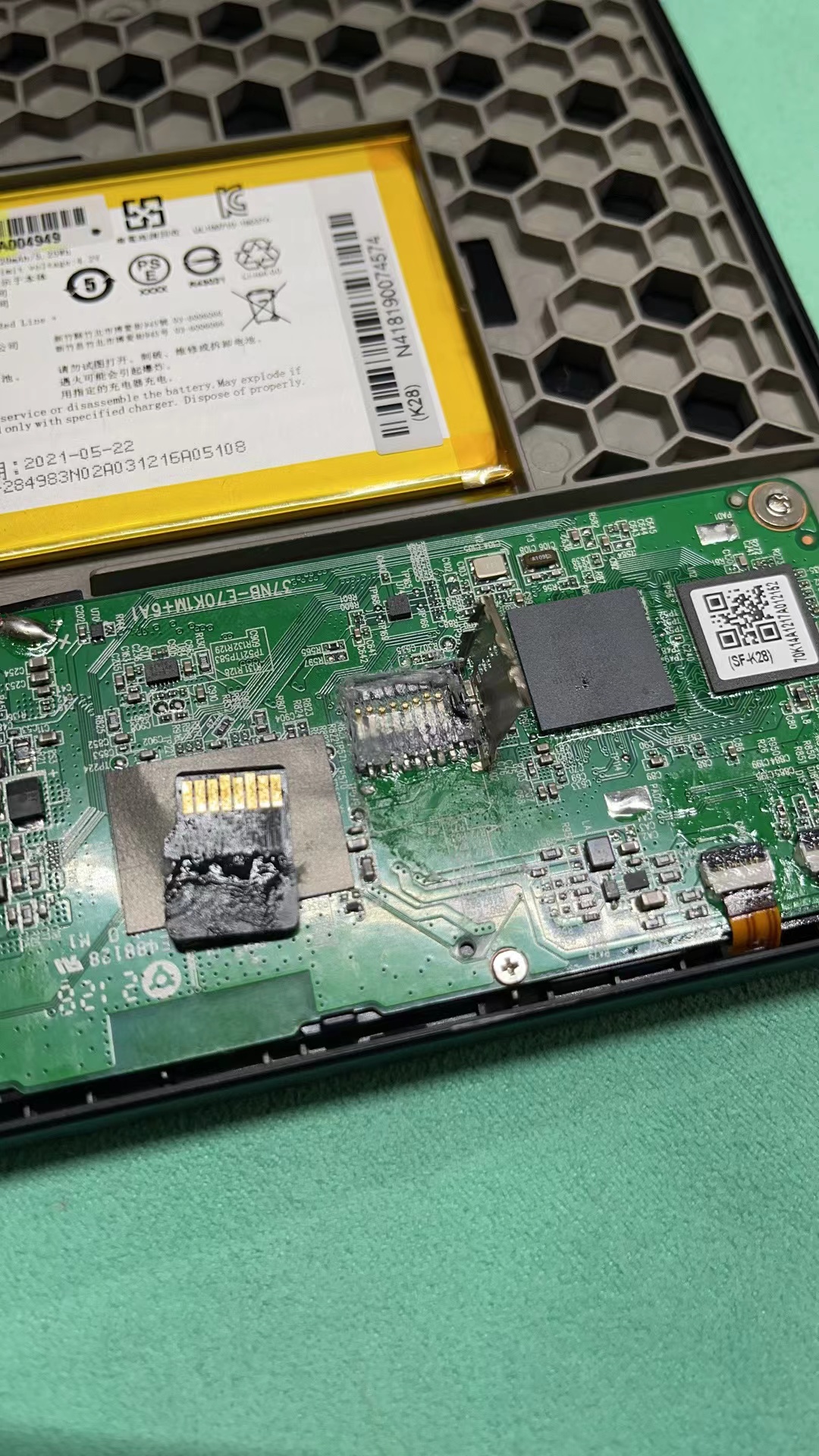

I still disassembled the KOBO Libra2
Because of some problems(Automatic reboot,reboot,reboot......), I decided to remove libra2 and replaced the 128g tf card to enter the system normally. Although libra2 uses a tf card, it is covered with glue, which is probably waterproof glue. If you want to change the card, please be careful~~~ Unfortunately, the problem I want to solve has not been solved. . . too difficult. . . depressed.

Whoa, you de-lidded the entire sdcard slot.
There were some pictures and discussions regarding the microsd in the first impressions thread as well
https://www.mobileread.com/forums/sh...d.php?t=342428
https://www.mobileread.com/forums/sh...43#post4166043
And some people in German ereader forum managed to remove the microsd card as well (from sister device Tolino Vision 6 which is also part of Rakuten/Kobo family of devices). https://forum.alles-ebook.de/thread/...0020#post90020 (unfortunately it seems you have to register to see this content)
However, one of those users also damaged their device in the process.
My Libra 2 also had a few reboots but I hope this is a software issue (happened in the past with sickel / watchdog too - the firmware checks for hangs and reboots if it thinks there is a problem) and so far it only happened when hacking around in the telnet shell, not during normal use. So I just hope its a case of the software watchdog being a little trigger happy, it's happened before in older firmwares

What type/kind of tape did you use to secure the sdcard to the slot again?

In addition to tape, a foam pad might also work (so the backplate will apply pressure to it)
or maybe just solder the legs of the lid back on... but its so much stuff so close together you really have to be careful with the iron
or maybe just glue the lid itself back on w/o getting glue in the sdcard path or contacts

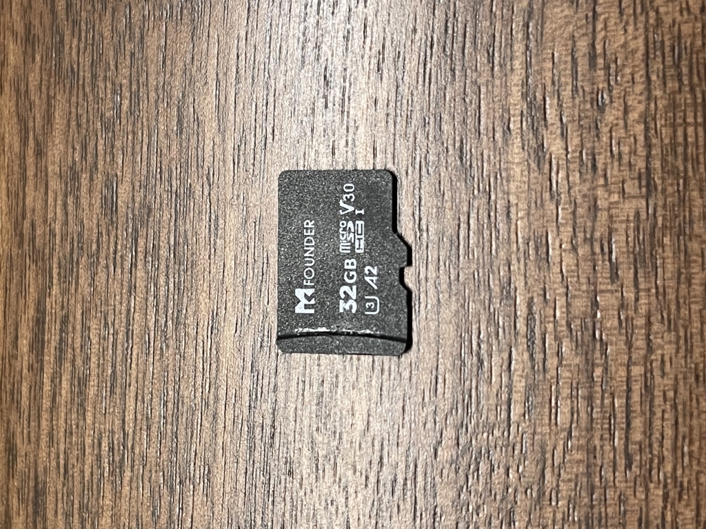

What was the brand name of the original sdcard?
Deobulakenyo is offline   Reply With Quote

I think ripping out the microSD holder is a very bad idea

much simpler (I guess) is to use instant glue to put the microsd lid back down
glue is our enemy but in this case maybe it can be a friend as well
after all, soldering is only necessary for electrical connection but the lid has no purpose other than holding the microsd card down
just make sure the microsd card itself doesn't stick

Yes,you are right,I just glue the lid itself back on

Yes,you are right~and I think this is the easiest way
This one
