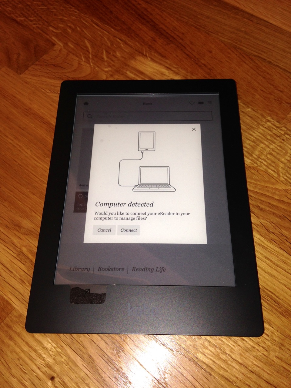

It has been switched off all night, just swiched it on (not plugged in) and this is what I get!
neil74 is offline   Reply With Quote

I hope you haven't been doing all this with the shipping screen cover in place, as it is in your photo.
Luck;
Ken

With the tab still on, the whole bottom part of the cover is draped across the IR path. It could cause their to be events for the touchscreen or other issues. In any case, for anyone who IS having problems, it is an obvious potential complication to be eliminated.
Luck;
Ken

Your kobo will not work properly with that shipping screen in place - it constantly thinks you are jabbing at the screen. No wonder things were a mess for you. Always go back to basics...
