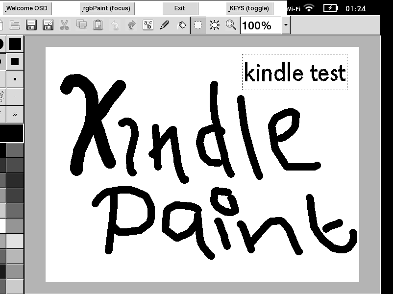

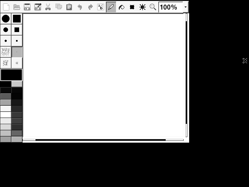

So I got rgbpaint and ardesia to run. in a fashion. ardesia is a struggle with its floaty toolbars. and its demand for xcompmgr. but it is runnable. I cheated and checked with a debian.
I can probably bundle up rgbpaint now, still needs love.
and an exit strategy.
A power button cycle monitoring dbus strap-on is required.
doable. I could look at that.
Could be run native but the save stuff wouldn't work natively as-is though. problem. so not native without a bit of a recode.
wrapped in a Xephyr those issues all go away though obviously.
so yeah. nothing perfect yet but a few early lo-effort contenders.

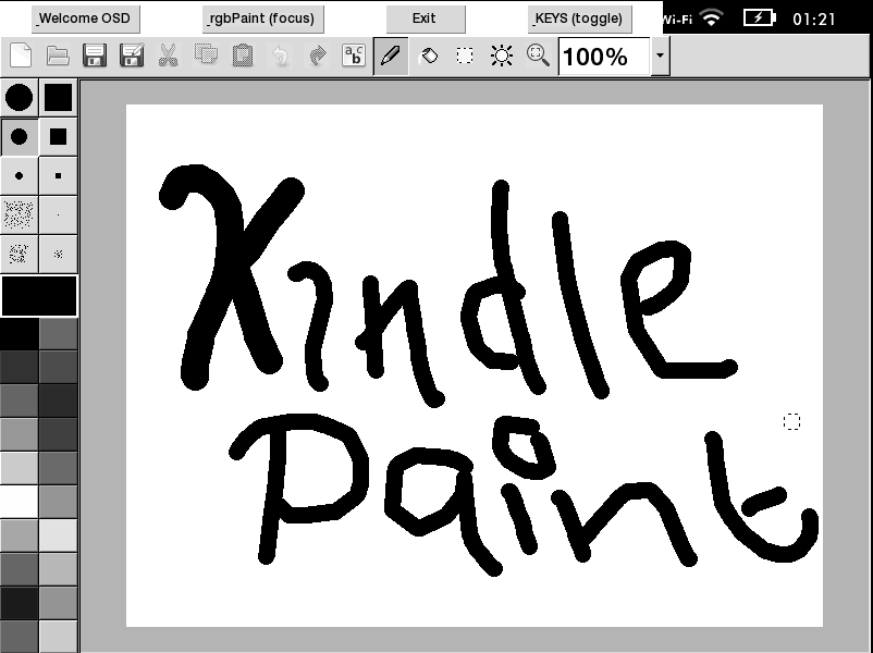

rgbpaint in a xephyr pictured. could do with fullscreening too...

Old 09-02-2013, 11:19 PM   #5
brianinmaine
brianinmaine ought to be getting tired of karma fortunes by now.brianinmaine ought to be getting tired of karma fortunes by now.brianinmaine ought to be getting tired of karma fortunes by now.brianinmaine ought to be getting tired of karma fortunes by now.brianinmaine ought to be getting tired of karma fortunes by now.brianinmaine ought to be getting tired of karma fortunes by now.brianinmaine ought to be getting tired of karma fortunes by now.brianinmaine ought to be getting tired of karma fortunes by now.brianinmaine ought to be getting tired of karma fortunes by now.brianinmaine ought to be getting tired of karma fortunes by now.brianinmaine ought to be getting tired of karma fortunes by now.
brianinmaine's Avatar
Posts: 457
Karma: 1287375
Join Date: Jan 2013
Location: West Gardiner, Maine
Device: Touch (5.3.7)
Nicely done - had a busy weekend so I didn't get to try rgbpaint yet, I was just trying to see if anyone else had a better idea. Thanks for the ideas so far. I'd also like to see it fullscreen, not sure how to do that? I still never tried to compile anything for the Kindle... This would be a great time to learn, I'm sure!
brianinmaine is offline   Reply With Quote

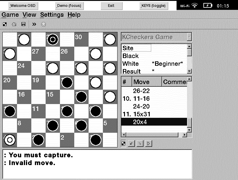

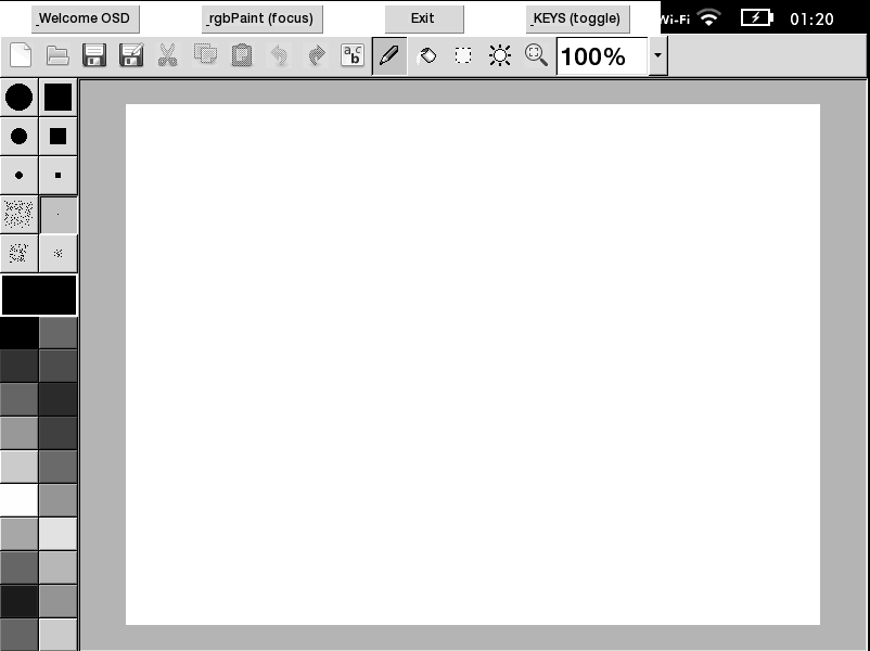

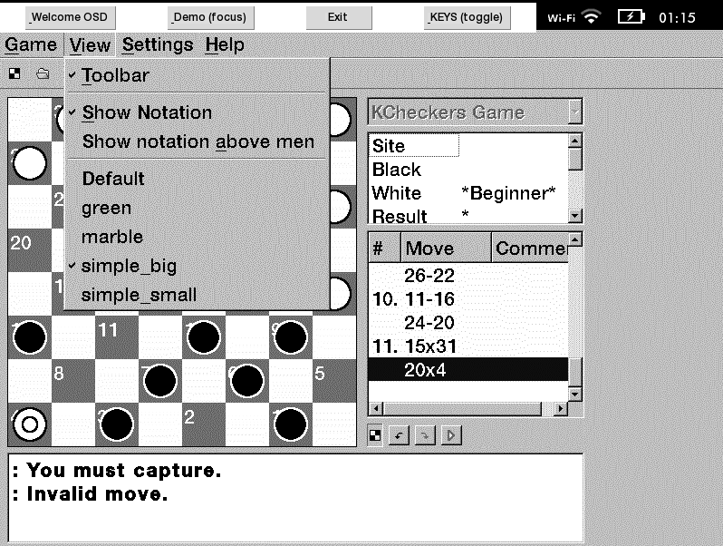

okay I got rgbpaint fullscreen and much tidier.
using the unreleased "fronter" to patch around naming issues.
KCheckers also works well via this method.
Old 09-03-2013, 12:41 AM   #7

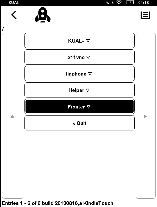

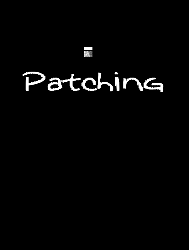

So the fronting method:
Well. it's not an exact science and doubtless someone will improve on that I have but:
In essence make a small patch to a loop-mounted COPY of one LUA file.
Restart window manager.
This provides a FAT based hook to do some window manipulation via scripts.
The patch file, an install process, the mounting process, the scripts, the binaries and the libs to all achieve this I now have.
It's a two pass solution - and not for any good reason.
First it will read over the name of the window being added (xdotool is a bit flaky here when it comes to generated subwindows so we need a second pass sometimes to ensure we get all the window names and their linked internal ID's)
Then we refactor that window name into something more conventional and re-inject the window back at the top of the stack.
The loop mount is just a fail-safe to prevent system corruption and will survive until the next major reboot. including surviving awesome restarts.
The installer process manages the mounting and can be safely run more than once.
I'll look to package up what I have.
The crux of all this is that you can from that point onward - Launch a window - With the WRONG naming convention - and have it handled by the native awesome installation.
Effectively paving the way for running a whole host of apps straight out of debian.
And removing the reliance on Xephyr.
It's far from perfect. and in some cases it is slow to recognise sub-windows. but it's what I got.

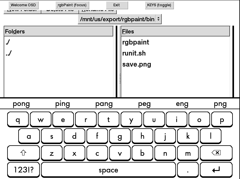

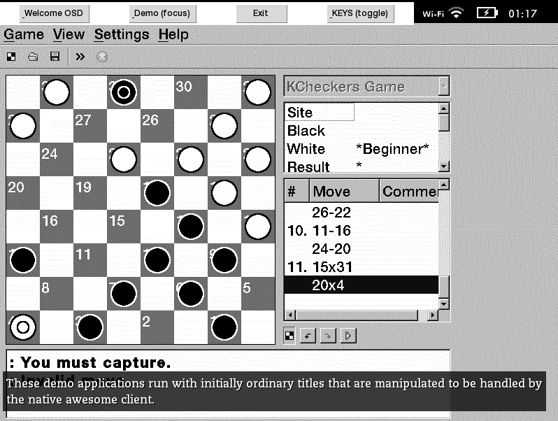

Kind of torn what to actually use the top ETCL menus for.
"Exit" is a given. "Application (focus)" seems helpful,, "Keyboard" might be handy, "Rotate screen" also nice to have, "Help messages" might be also useful.
I think I will change the "welcome message" to something more useful like screen rotation in the medium term. or someone else can...

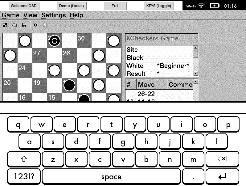

There is a known issue where the native keyboard is BEHIND the layer that needs it. Opening the keyboard first actually bypasses this issue.
Bundled an OSD in the form of aosd_cat, also a top menu window decorator concept using ETCL (someone else's work re-used) and two demos so far.
The code to search for the secondary submenus is WAAAAY slow and needs refactoring. Like way slow. Like slow.
Will do some more tests but it's not far from workable.
Old 09-04-2013, 10:37 PM   #11
twobob
( ͡° ͜ʖ ͡°){ʇlnɐɟ ƃǝs}Tır
twobob's Avatar
Posts: 6,586
Karma: 6299993
Join Date: Jun 2012

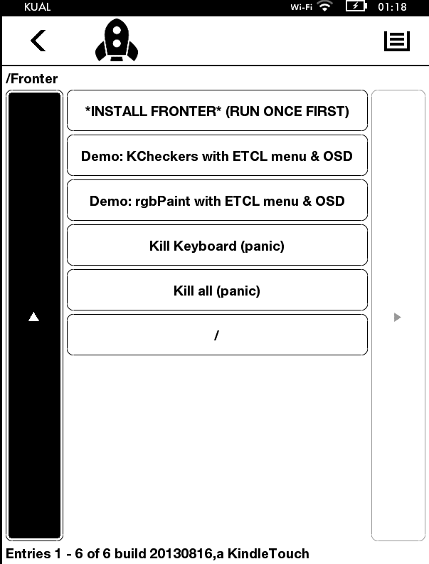

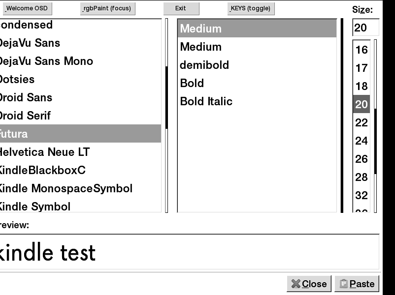

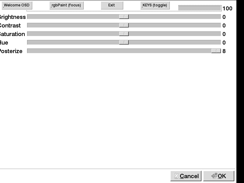

Some screenies.
ID:	110420   Click image for larger version
ID:	110421   Click image for larger version
ID:	110422   Click image for larger version
ID:	110423   Click image for larger version
ID:	110424   Click image for larger version
ID:	110425   Click image for larger version
ID:	110426   Click image for larger version
ID:	110427   Click image for larger version
ID:	110428   Click image for larger version
ID:	110429   Click image for larger version
ID:	110430   Click image for larger version
ID:	110431   Click image for larger version
Old 09-05-2013, 01:07 AM   #12
brianinmaine
Posts: 457
Karma: 1287375
Join Date: Jan 2013
Very impressive! My two favorite programs as demos! Can't wait to try these. I also like the fronter toolbar idea.
